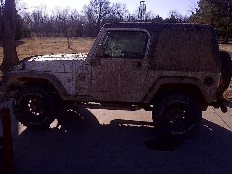

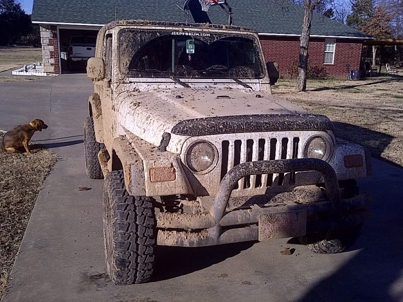

post #144 of 196 Old 01-15-2012, 05:41 PM Thread Starter
HanksRide
Location: Greenwood
Posts: 1,538
Woke up this morning to this!! She went out with her boyfriend and other jeep friends yesterday/last night to one of their favorite hang out spots..
Her and the her boyfriend spent about 10 to 15 bucks at the car wash this afternoon..
She normally doesn't get in the mud with hers, but after she sent me some pics last night of some friends jeeps that were getting muddy I told her she better not come home with it clean...

post #146 of 196 Old 01-16-2012, 10:33 AM Thread Starter
HanksRide
Location: Greenwood
Posts: 1,538
Originally Posted by LRod View Post
Playing in the mud is fun, cleaning it isn't! I stay away from the mud! she will too after she has to clean it a few times.
Yes I agree and I think she figured some of that out yesterday. Mud goes on a lot easier than it comes off.. They did a pretty good job cleaning it up..
