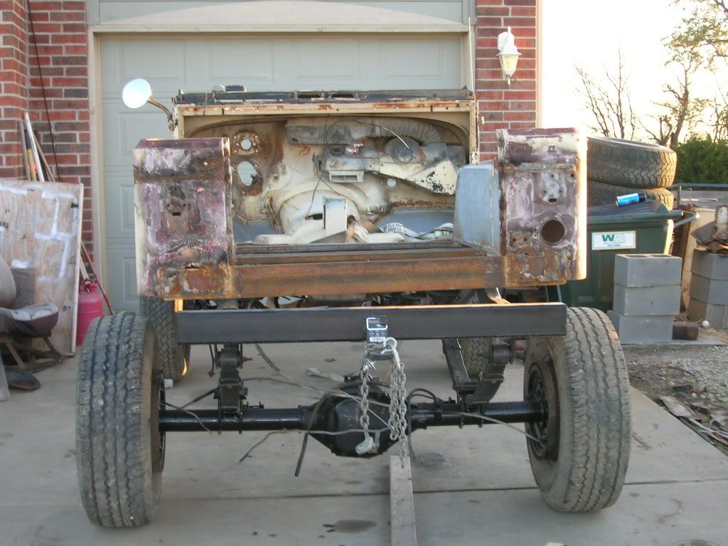

The 14 bolt is a monster. One of the best axles ever built don't get me wrong. But If you are thinking 35's well Good luck as it will drag every rock up the hill with you. Here is a 14 bolt on 33's that we had on just for mock up. You will get the point. Now then. Before the jokes start flying. For anyone that ever wondered what a spring over on 4" RC springs would look like. We did this just for fun. Funny huh? But back to the 14 bolt rear. You see how on 33's it is prob. 7" off the ground. Needs 38.5's or bigger. to not get hung up.
Todd
Todd, I can not view the pictures. Can you try to fix the link? I'm very interested to see what 33s on a 14b look like. Thanks.
Chevy 12 bolt on 33's
Chevy 14 bolt on 33's
