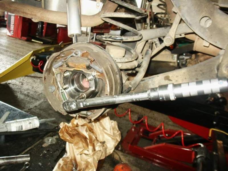

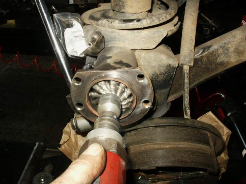

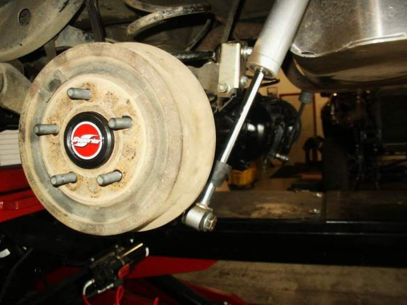

Being one of the original testers of the c-clip eliminator I had a leak on the passenger side because of installation issues. When in stalling the c-clip eliminator I recommend placing a small amount of RTV on the outer section of the oil seal (seal and axle housing side not the shaft side) to insure proper sealing of the seal. mine leaked around the seal (between the seal and axle housing). I have had my kit installed for over two years and after adding the RTV I have had NO problems with the axle shafts leaking.
I would recommend this kit to anyone that wants a bit of protection without the large budget of having to upgrade to a Dana 44 (which I might add, has the same type of seals and that recommend RTV be added during the installation) or 60's. Have you priced them out?
A small peace of mind knowing that "if" I break my axle that it will not walk all the way out and strand me on the trails.
You can't break the eliminator. It's a machined housing end with larger D-44 sized bearings. The axles are possible to break, but so far, that's not happened. Granted, there is not a huge amount of them in use, but the testing I supervised would likely scare anyone with what I had them do and all the parts survived just fine.
Mine are still going..
