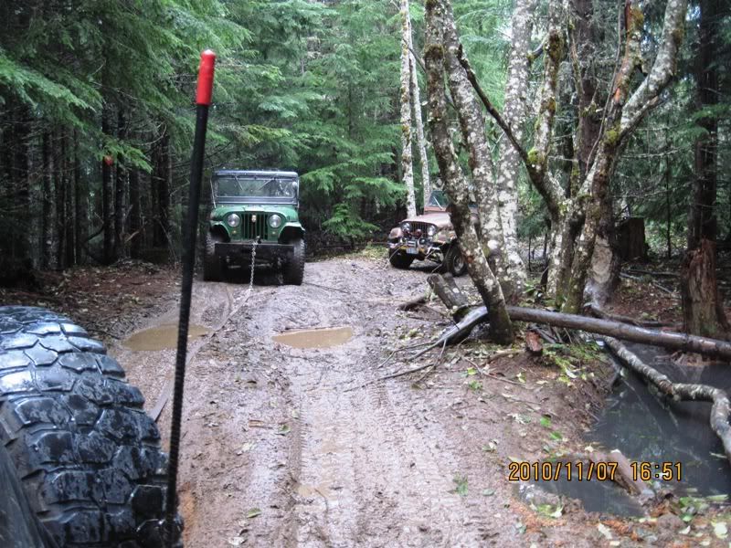

Yeah? Mine has 150k on it. Never broke, never even squeaked...nothing. Most reliable rig I ever owned. In the following link, there's references including photo's of me pulling a Rubi all day long, with the dreaded d35. http://www.jeepforum.com/forum/f58/m...010-a-1102074/
In this link, I'm pulling 2 broke down Cj's with the dreaded d35...http://www.jeepforum.com/forum/f58/e...-flop-1125830/
My point is, it will hold up to plenty of use and abuse. That said, I don't for one minute think it's the top of the list, but using it within reason, it can do it's job well for many years & many miles...
