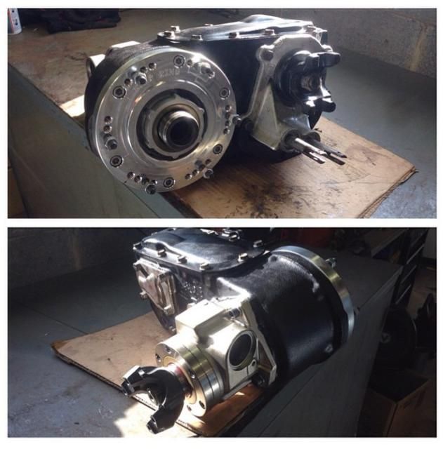

I built these lever shifters, worked great. Switched some things up recently and went with NWF Cables

My cables shipped yesterday from NWF

PS. Very nice! I went with the Novak hd output to shorten the length of the output. That should allow me to keep it streetable here.
