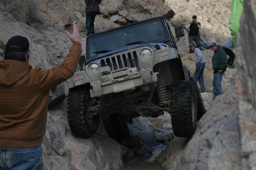

I installed an Aussie Locker into my Dana 30 this past week and took it off-road for the 1st time yesterday. I have to say this locker is awesome! It actually feels like I still have an open diff when I'm in 2wd and on the street - even through turns, I can barely hear it clicking, and that's with me trying to listen for it. Off-road the locker worked exactly as advertised, I had no problems with any obstacles that I tried - I ran it through a V-notch that usually has 1 of your front tires up in the air (although my recent suspension upgrades didn't allow this to happen to me ) I could fell it pulling me forward. It was muddy and wet but I had no traction problems all day. Thanks to Northridge 4x4 for the Locker - $249 shipped is a great deal for some awesome traction. On the trail the steering is noticeably tighter, but that's expected of a locked front axle. I was planning on getting the Tera 2low kit (under $200) which would allow for the front axle to be disconnected at the transfer case while in 4low, but it wasn't as tough as I was expecting, so I just saved myself about $200 . If you've been thinking of adding a locker but are on a tight budget - I'd say the Aussie is a great choice - well engineered and built with quality, easy to install (http://www.4x4xplor.com/aussielocker.html) and works great.
