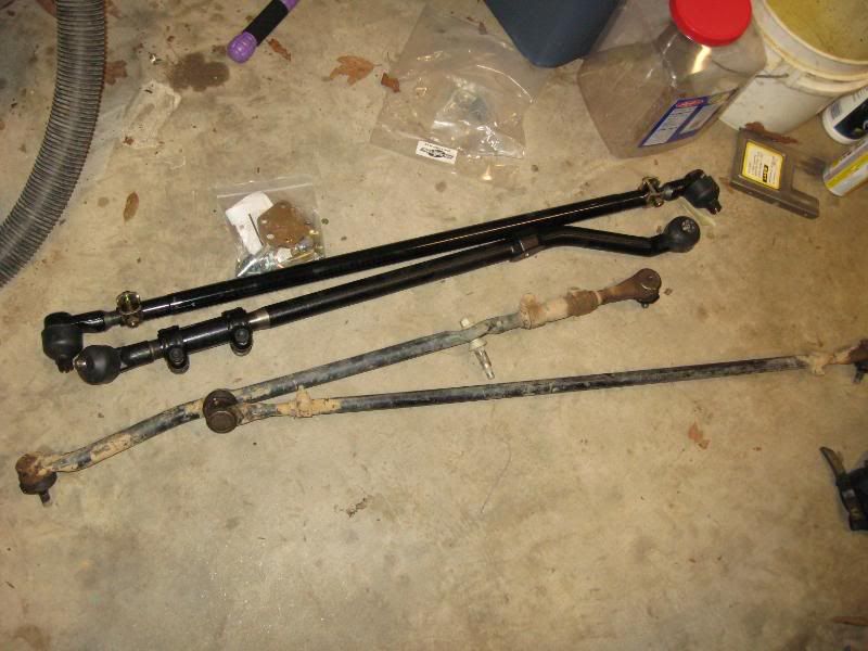

BYuen's Avatar
Posts: 4,854
Originally Posted by LuckRider View Post
Did you have to ream out the knuckle for that? I was under the assumption that you didn't, and that is why I thought it might.
Nope! No reaming necessary Complete bolt in. The stock tie rod won't be able to screw onto the much larger threads on the Currie rod ends.
EDIT: I guess he could use his stock tie rod as a spare... but he would also have to have the stock TREs too.

Posts: 4,854
Currie vs Stock
2001 White TJ Sport
