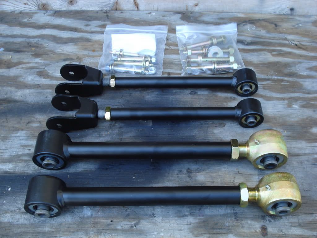

very nice! congrats. How was the install?? It doesnt bore me. Thats the exciting part?? Where are the pics...come on boundless!!

ok ok you got me... it got dark on me so I will take pics tomorrow when I finish up the alignment and post them.
The install went well, thanks to all the good advise. Took me about 2.5 hours by myself.
YES I will replace the rears with Currie's also and outboard the shocks and relocate upper spring buckets at the same time. little by little

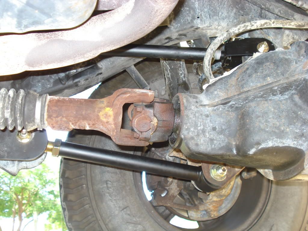

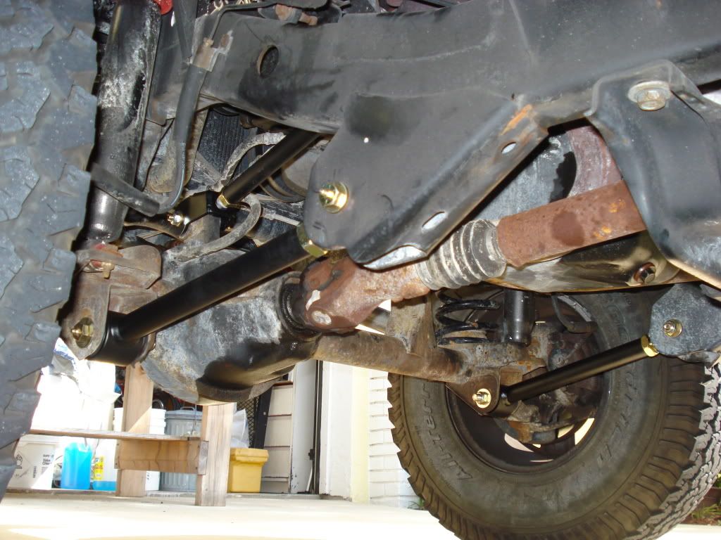

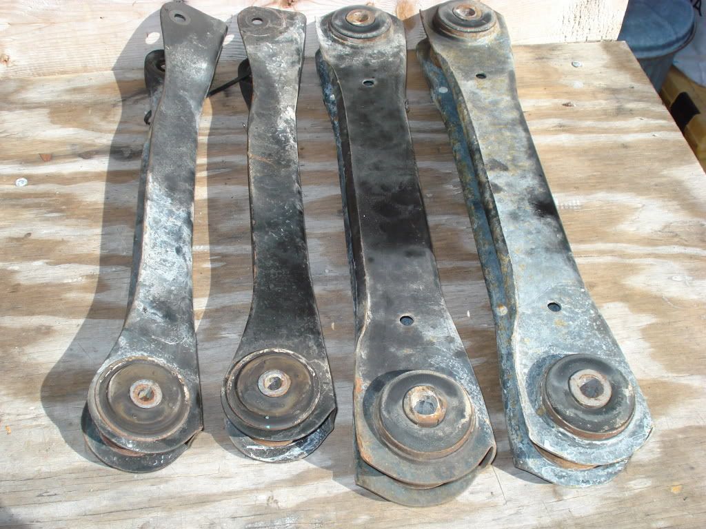

More pics as promised
Notice in the below pic the lower control arm (3rd from the left) is the worst bushing I had. Tops actually looked good
Here is a shot of my pinion angle... looks like I might be able to squeeze out just a little more caster.
And a couple suspension shots from the front and from the rear. Oh and yes my pinion seal is seeping, but I have a HP30 to swap in when its done.

may be a stupid question, but what is/was wrong with the rubber bushings in your pic? I dont see any cracking or separation in the rubber.....

That doesn't mean it's capable of keeping the axle rigidly constrained. IMO, with anything over stockish tires, they aren't up to the task.
x2, oh and thank you Imped, you were a big help
Originally Posted by twichers View Post
Boundless -
Thanks...
Not a stupid question at all, here is my attempt to explaine it (from another post of mine in a thread about DW)
Originally Posted by Boundless View Post
most things (not all) done to stop DW are like a cough suppressant, you stop coughing but the reason you coughed is still there... you're not cured yet.
Yes you stopped the wobble with new tires, but ask yourself what allowed the front end to move like that?
I am not a Doctor by no means, but worked with and learned enough the hard way to know that the stock bushings are not up to the task of holding the front axle secure (the sickness) when faced with the leverage of larger tires (the tickle in the throat) and at the link angles caused by lifts (the weak immune system). So as soon as something is not perfect the cough will return and it may not as long as there is no tickle.
Well that's my way of explaining the plague death wobble.
so even if the stock bushing are not bad, they still are not designed to handle the task we throw at them. Throw in the fact we over flex our suspensions much farther than stock, its a wonder the stock bushing hold up at all.
