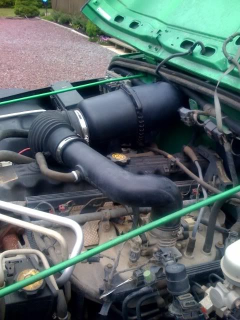

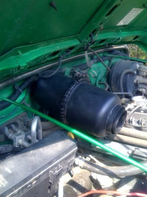

Cowl Intake with Windstar air box
I got the idea from a guy on Pirate, I decided to use the entire box, he shortened the non filter holding portion of the box.
I trimmed the factory vacuum fittings, and plugged them with wire nuts, then painted them black

Just wanted to post this here for anyone looking for how to shorten the Ford Windstar Airbox, as mentioned earlier in the thread. This is how I did it anyways. Background: Airbox is out of a 97 3.8L Ford Windstar, picked it up at a local salvage yard. I put it into a 2006 LJ Wrangler.
I took the part of the airbox that the MAF sensor used to be in, and cut out the middle section.
Then, I cut a few short tabs out of some sheet metal and bolted the two new halves together. I used some ducting tape (the metal kind) to seal the inside.
Then I used some epoxy to make sure it was sealed well.
I finished it off by trimming off the extra bolt threads and using more tape around the outside.
After that, the install was just about the same. I went ahead and picked up some 3 inch flex tubing from Autozone (in the ricer section I believe) and two hose clamps. This let me use the flex tubing to go through the firewall which gave me better access to the dipstick.
