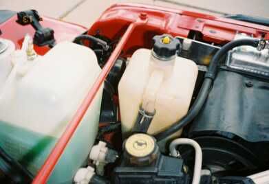

the reservior bottle has an overflow port on the back...pretty common if the bottle is overfilled to spew coolant out of there. usually it sprays all over the inner fenderwell and inside the hood. smart folks add a rubber hose and vent it under the jeep.

Also, if you shut it down while it was Very hot, the circulation stops and the engine block can increase the temp of the coolant in the engine itself. It can puke.. Always good to let it idle to cool down. Same for auto transmissions if they get hot.
That happens during a steep climb too.
No more overflow under the hood for me...

I have the same thing happen after doing some steep climbs while offroading. Always thought it was coming from the overflow on the coolant bottle. Thanks for confirming my thoughts and I will be adding that hose.

Replaced my radiator cap, it definitely was part of the problem and not holding pressure...
Unfortunately the new cap revealed the terrible shape my upper rad hose was in and split it in about 10 mins . I will be replacing both upper and lower hoses tonight.
