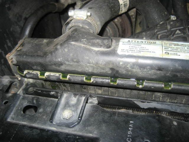

I have a coolant leak and it only happens in the winter (cold outside). This happened last winter too. I had replaced the top radiator hose prior to the problem last winter. And after the problem I had bought a bottom radiator hose but by then it had stopped.
Well it just started back up today. I'm going to look around tomorrow in the daylight, but thought I'd post some pictures and see if anyone can give me advice on where to start.
Edit: There was enough coolant leaking that when I parked, the leaked coolant was basically smoking out of the engine
Coolant on inside of hood
Top of radiator
Other view of radiator
Bottom of radiator
Coolant that had leaked on front axle
Thanks for any help

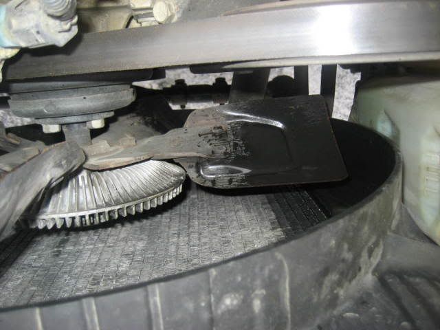

So the cap was definitely not the problem. I let my jeep run on the driveway for a bit, and sure enough coolant started dripping. I had wiped down quite a bit of the radiator area so i can see where new coolant landed. It seemed to pool around the top edges of the radiator. And I think the fan edges have coolant on them as well.
I'm going to go look around some more. But here are a few pictures I took. Let me know if you'd like me to take a picture of something in particular that may help you help me

I can't tell from the pics. Is that the OEM radiator with plastic tanks and metal body? If so, they are notorious for leaking along the seams where the tank is crimped on. Two different materials with two different expansion/contraction rates. Thankfully the radiator is very easy to replace. Be sure to get an all metal one.
Yes it is OEM. For the materials, I never paid attention, but I'm guessing its the plastic/metal combo.
This leak only happens during the winter (this is the second winter its happened). So its definitely an expanding/contracting issue.
Is replacing the radiator the only way of telling if that's the problem? Or would a pressure test help confirm?

I just replaced the OEM radiator in my 2000. Like yours, mine only started leaking when the weather turned cold. The original radiators are prone to separate where the plastic is crimped to the metal. I bought an all metal replacement from Radiator Barn for about $160 shipped. They're super easy to replace. I think it took just over an hour from start to finish.

Well when i tell you what is going on you probably won;t beileve me but here goes.......you replaced the upper hose clamp with a non factory type screw clamp.They don't compensate for heat and cold like the factory spring type.SO when it very cold out the plastic rad shrinks but the screw clamp doesn't,after you start the engine and the coolant start to expand it pushes out the loose hose clamp area until the plastic rad heats up expanding sealing the leaks.
I gO THROUGH THIS EVERY year too because some idiot tossed the factory clamps!
