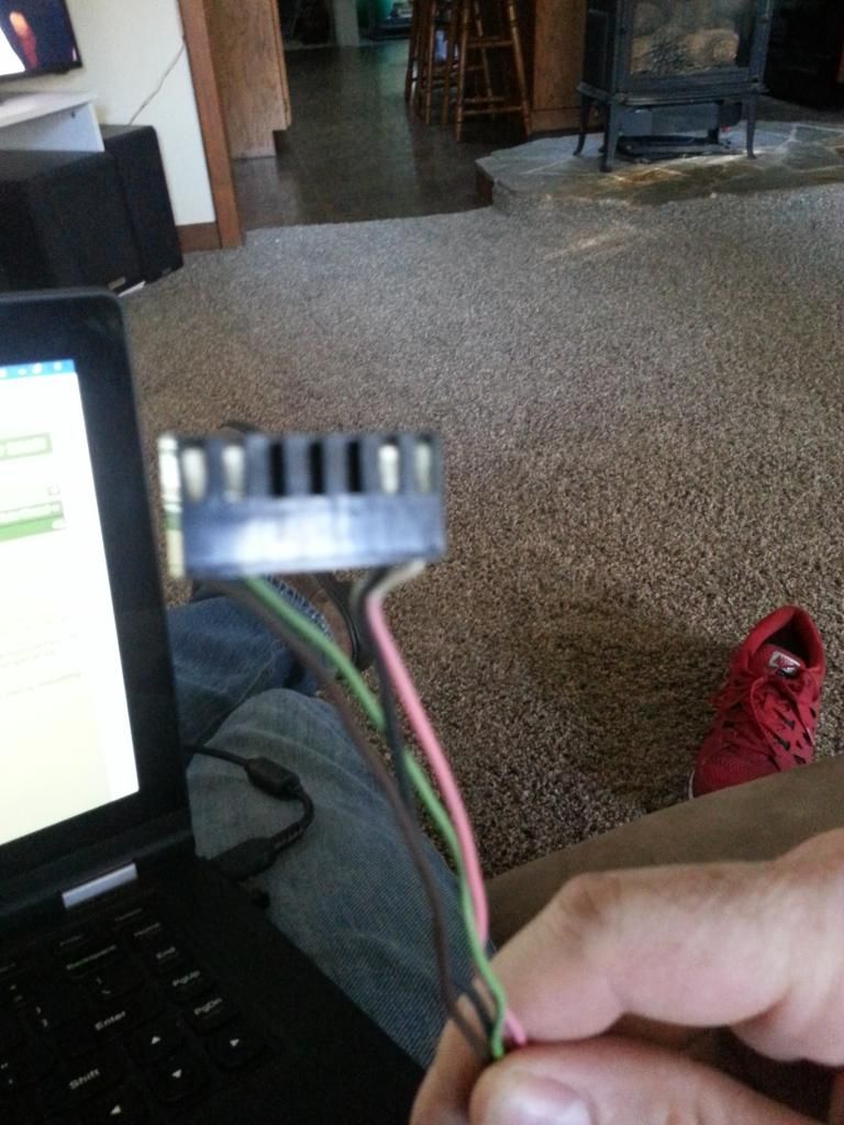

rbkelley89
Location: chico
Posts: 871
damn it seems like every mirror is different i just took out the middle ones. From what i've read i only need 4 so before soldering i guess ill do some more research heres what my pigtail looks like. its a gtnx 177 im pretty sure too i just need to figure out whats ground (-),power(+), and the two that go to the temp sensor.
