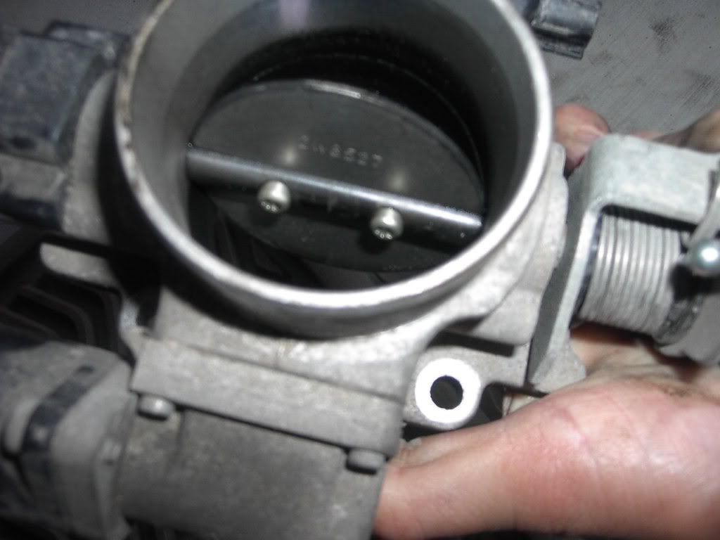

Take off the intake, disconnect throttle cables, unbolt throttle body, get an old toothbrush and some carb cleaner, spray, scrub, repeat if necessary.
Before:
After:

Nice Job! So what are the sensors that are showing in the picture?
The top is the IAC (Idle Air Controller), the right one is the Throttle Position Sensor, and the bottom is the MAP sensor.
