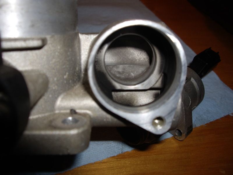

However, would like to throw out there that 05,06 (not sure about other years) are only slightly different:
IAC and air chamber vary slightly, but are still in the same location as other years.

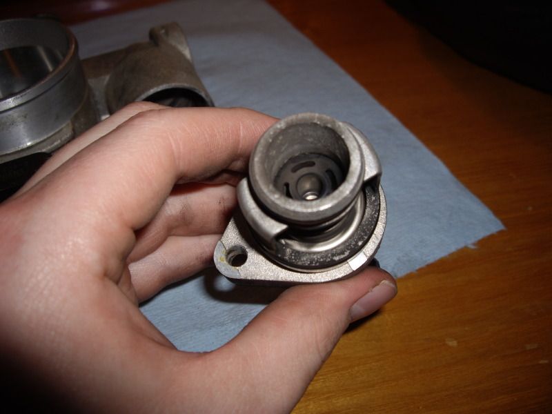

Originally Posted by scottbr View Post
Good post. I'd add to be careful with the IAC housing gasket unless you are making one or have a spare (they are a pain to fabricate from gasket stock). It cracks easily.
Also to have a VERY clean surface on which to work.
Lastly, USE EYE PROTECTION. Throttle body cleaner is some nasty crap to get in your eyes.
I can't find where to buy an actual pre-made IAC housing gasket, so I was gonna use silicone but I wanted to see if the Permatex Right Stuff would be ok to use? It says it's sensor safe but it also says reccomended for oil pans, diff covers, valve covers but nothing about intake parts. Here is the link to the stuff I am talking about. If that's not ok to use what should I use? Just the sensor safe blue RTV, or should I use the sensor safe copper since it has a higher heat tolerance?

You can cut a new gasket out of gasket material available at any good auto parts store. NAPA is where I bought my last sheet which looks/feels like a tough thin cardboard. I would not use RTV but if you end up using it, that it says Sensor Safe means it is safe to use around your 02 sensors which is what that 'Sensor Safe' phrase is mostly about.
