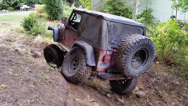

I have a mid arm 3 link front and rear on my jeep originally set up with 2.5" lift springs, 11.5" travel front shocks and 13" rear outboard. My springs unseated almost 2 inches in both the front and rear. Ive run it like that a long time untill recently putting a set of re 5.5" springs because they matched the shock length without unseating. The jeep handled the same if not better jacked way up with the stiff springs. I went from having 6" downtravel to 3.5" i swaped to currie 4" coils with a 3/4" puck up front to fill unseated space and lj 3p rear coils. The up and down travel balance is nearly exactly the same. I dont have a fair handling comparision with the currie coils due to a 35 slpine spool i stuck in at the same time. The off camber feeling is no different, better or worse than the 2.5" was.
