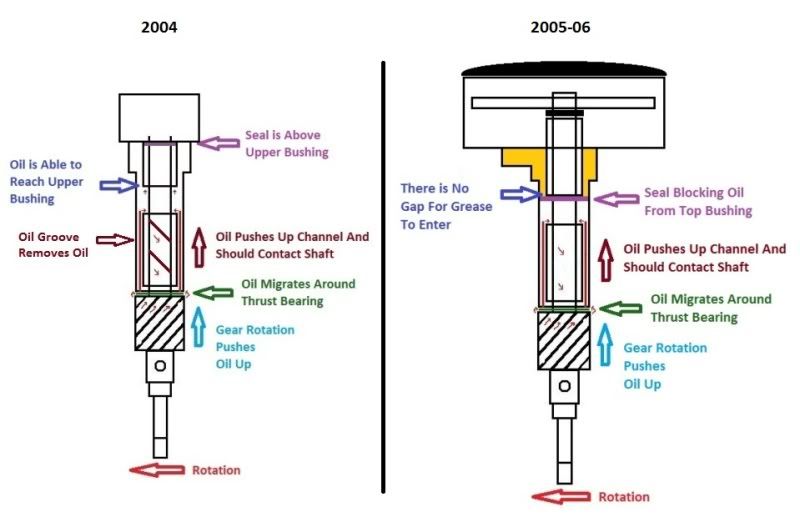

My version has:
1. Pistol grip to allow grease pump with one hand while supporting gun
2. Attached needle point, since I have the flush grease fitting in the OPDA. This allows one hand to hold and pump the gun while the other hand holds the applicator. I dis-assembled a needle adapter to discover the correct 1/8" NPT thread at the base of the tip. Screws right on the flex hose, eliminating one potential leak/flex/come apart point.
Filled with Aeroshell 33MS. A slight odor, but I like it.

Originally Posted by jeffjeep1 View Post
My version has:
Mine looks just like that. I need a longer and more flexible hose to get in there while it's installed.
You have to have a pistol grip for the flush mount style. The only thing I'm not sure about is generating enough pressure to squeeze the grease into the tiny gap between the bushing and the shaft.

My modded OPDA is installed now (as of 13:00 today). I did grease it on the bench, yesterday. Initially felt resistance, then grease flowed in as one expects. I think it is the small needle opening being sealed by the spring pressure of the ball. One the pressure exceeds the spring, it flows in.
Growing up, I used to have a fitting that threaded onto the grease tube/hose with a rounded ball end that fit into the "bowl" of the flush fittings. Unfortunately that piece is long gone. Thinking about it, the OD of the needle seals better into the fitting with less grease spreading around.

I had to add an adapter to get the needle to fit into the engine bay to reach the fitting. I also had a spring hose support that I have to slide up. My stock grease gun hose was 12 inch and it just fits.

Could it be possible to drill straight down the center of the shaft to the center of the upper bushing and drill a cross hole right at the center of the upper bushing? You could then tap the top for a small fitting and just pull the dust cover to grease it from time to time. I'm no machinist but I have seen this type of set up in other applications. I.E.- Possibly a 1/8" hole down the center and a 1/16" cross hole.

Originally Posted by OldenEagle View Post
Just thinking out loud....
What would be the benefit of that compared to going through the bushing? It seems more difficult and could weaken the shaft. It's not too difficult to get to the zerk on the housing. The flush mount zerk is a little more difficult, but not enough to justify trying to drill through the shaft. You could drill through both sides of the bushing if you wanted more grease access.
If we are brainstorming, I was thinking of removing the upper bushing and seal. Cutting the upper bushing in half so that when reinstalled you add the bushing followed by the seal. You could make up the difference in the bushing length with a thicker plastic washer. That could duplicate the 2004 model OPDA and allow oil to contact both bushings.
I don't know how difficult it would be to remove the bushing and seal. FOG may have some suggestions on if it's feasible.
You must know that cutting the upper bushing clear in two would not be productive?
I'm no expert. I suppose the 2005-06 OPDA may need the extra support because of the target wheel. Otherwise why not make it exactly like the old style bushing from the factory? The factory bushing sticks up about 3/4 inch. That doesn't seem like much to me. The internal section of the bushing and seal is an inch or so (I'm going off memory).

Okay, something I missed here. What is the object of using a flush fitting that needs a needle adapter? What is wrong with an ordinary grease zerk? I've done 2 of these now and the grease zerk seems to work just fine.
One observation on the '06 model I did a couple days ago. This Jeep has about the same mileage as mine, 20K plus or minus, and was built the same month, 8/05. Both are Rubicon LJ's, his has an auto, mine is a 6 speed. Mine had a noticeable less amount of wear on the gear. The shaft looked the same on both. I don't think his gear is shot and we re-used it, but mine had less wear. I use Mobil 1 High Mileage 10-30 and Donaldson 50299 filters for a 7 quart oil system. I change my oil once a year whether it needs it or not. He takes his to Jiffy Lube type places and has no idea what oil is used. Looking at the gear made him a convert.
There is no real difference in the zerk choice. When I did my first install I put the grease fitting hole a little high so there was some clearance issues fitting a traditional grease gun. I went to the flush style zerk because of that. There may be a fear that the aluminum is too weak and the long shank zerk may break off. I don't believe that and I've done two for others on the board and both were with long shank traditional zerks.
