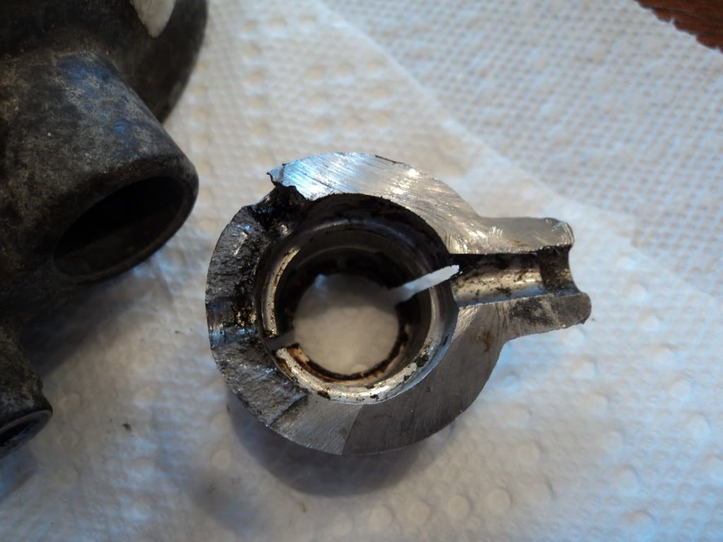

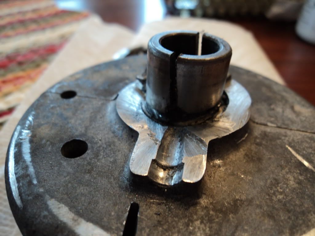

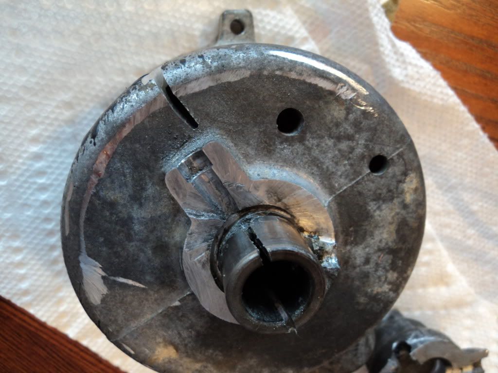

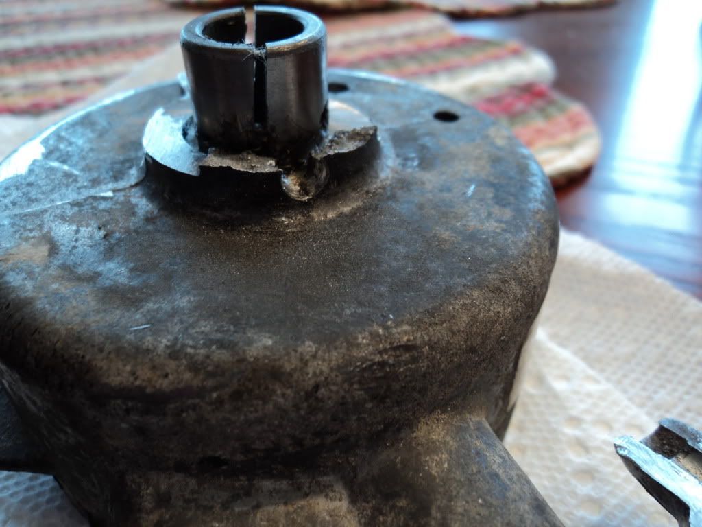

Following the great advice from Willydigger, BigBob, Fog etc...I took on adding a zerk to the upper bushing area. However, even with Willydiggers nice color drawing of the assembly and zerk location, I still had a hard time visualizing the 2nd hole and purpose (180 degrees from the factory plug). In particular, only drilling through the "outer wall." So I cut my old OPDA upper bushing in half so I could get a good visual. So in case anyone else is a visual person like myself, I added some pics. Please ignore the vertical cuts in the inner bushing.

Wow, those pics are awesome! Do you have a shot of the seal below the upper bushing? Where the grease is supposed to leak out?
The grease reservoir is smaller than what I thought.

What is the large cut out area on the right side of the first picture? Could that be used to insert the zerk? I assume not but it would make things a lot easier!
