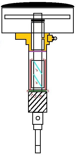

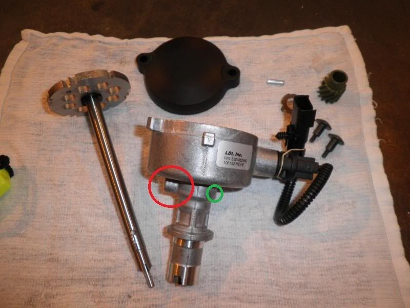

I'll take a stab at the location. FOG correct me if I'm wrong and I'll change the pic.
Here is where I believe FOG is recommending the install of the zerk. As you know the factory location is between the OPDA and the engine. The chamber where the grease sits can be drilled without contacting the bushing. This is noted with the green circle.
Below is a bmp of what the top bushing looks like. PLEASE NOTE, I haven't dissected the unit to say that this is 100% accurate.
The yellow represents the grease. The purple line under the top bushing is the seal. As designed the grease should have a port between the bottom of the bushing and the seal. I believe FOG is saying this port gets restricted or fails in some way to prevent the hot grease from leaking into this passage.

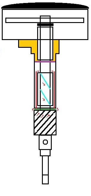

Here is what it would look like with the zerk installed. Placement and drill size is still not confirmed.

FOG - any comment on the diagrams that willydigger posted, or did he pretty much nail it? Also, if you could address these parts of my questions, I would really appreciate it.

Willys diagrams are right on the spot. He is a better artist than me, I'm doing go to draw a straight line with a ruler.
As far as installing the zerk, you need to knock the pin out the holds the gear on and remove the gear before you drill any holes. When you do drill the holes get a new bit so its nice and sharp. Also get some heavy wheel bearing grease and dip the drill bit in it before you start drilling. This will hold the metal chips on the bit. When the bit looks like its getting loaded up with chips, spray it off with some brake parts cleaner and put more grease on it.
As far as setting the timing, what you do is pull the spark plugs and rotate the engine by hand till your at top dead center on plug #1. You can verify this by having compression on that cylinder and lining it up with the marker on the front of the engine.
With the engine at TDC, put a locking pin through the wheel in the CPS assembly so it locks it to the case. With it locked slide it into the engine, if it doesn't slide in pull out and use a screw driver to turn the oil pump to line up.
Once you get it lined up tighten the clamp to snug it up. Now start the engine and let it idle for about a minute then rev it up to around 2K RPM and hold it for about 30-45 seconds. If you don't see a check engine light come on then your with-in the acceptable tolerance and the engine compensates.
If the check engine light does come on, reset it with any cheap scan tool (you can get them for under 50 bucks) and adjust the CPS clockwise by a couple of degrees and rev the motor again. If the check engine light comes on quicker and lower RPM then you need to go back the other way.
Its a process of trial and error that will save you the 100 bucks the dealer wants to reset it.
