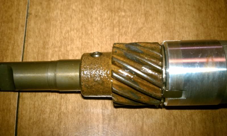

here is a photo of mine i took out of my 03 with 77k on it jeep runs great right now no ticks

this was the one i replaced, only number on the saft is the part number 53010614aa and a number under the manufacture standard 1063
