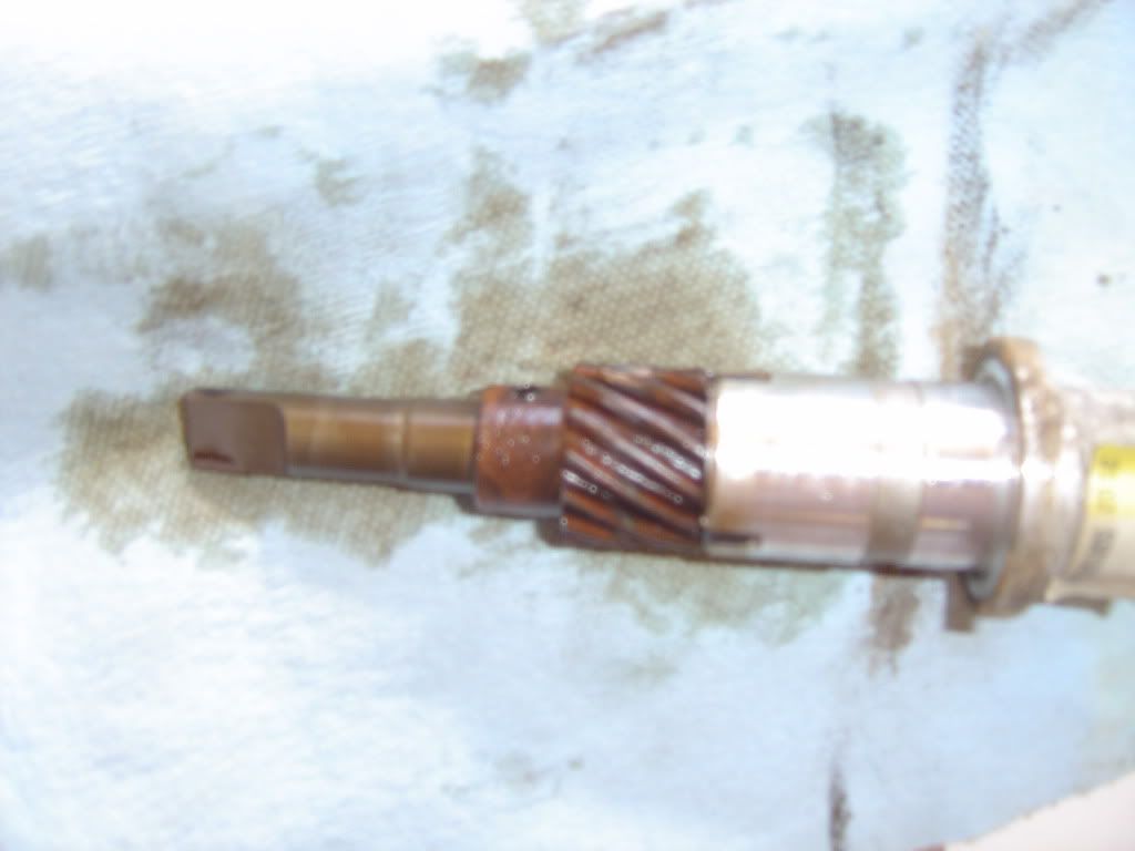

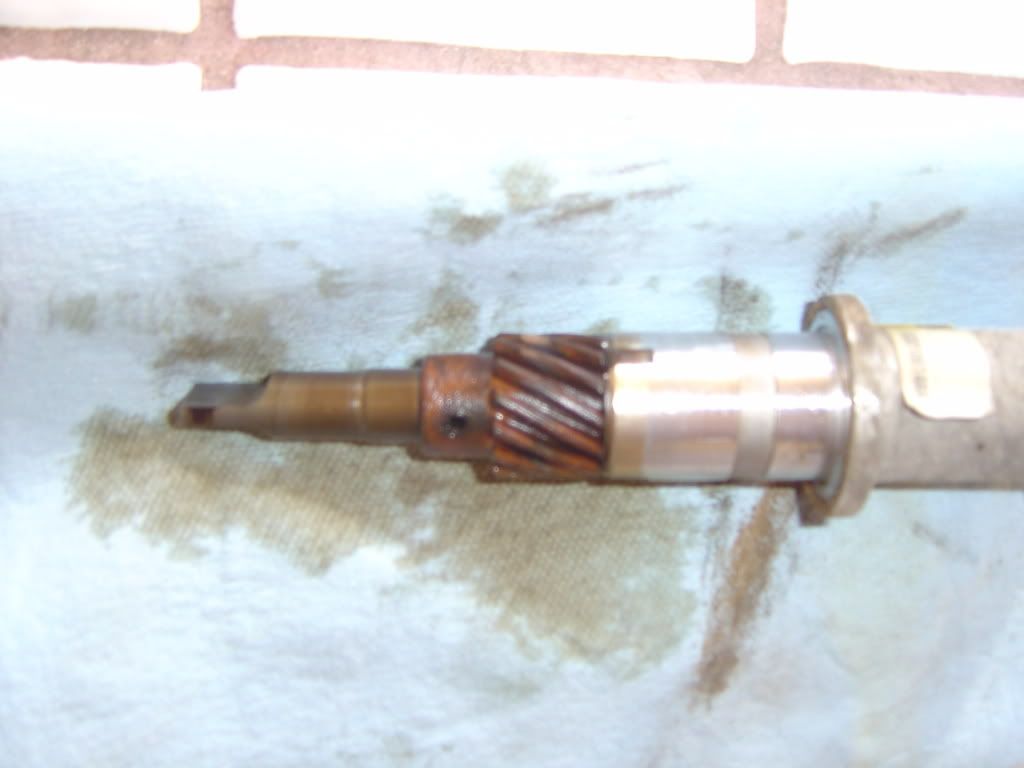

Few pics of my 03 at 115K. Surprised the OPDG looked as good as it did however I know it's done because it's churping like a belt. I have the ticking and it's starting to lose power in the Mountains, recently she started throwing some codes for misfire in the 5th and 6th cylinders.
Sorry for the poor pic quality
Spoke with Hesco and I will be ordering a new cam, push rods, lifters, performance valve springs and retainers and will need to change to single grove valves (due to the .470 lift of the cam) all for a parts cost topping $800 and a labor charge of $940... also will be changing the oil pump to a high flow OP from Hesco for an additional $300 in labor and part (may do this myself).
Thing that bothers me the most about this is the fact I have spent about $1800 in oil over my rigs life in the motor alone (Mobil 1 first 80K, switched to Royal Purple at 80K to increase the zinc) and should have got 300K plus before having to drop this kind of coin... doesn't include all the other stuff I have had to change at this point like the header for example. DC
