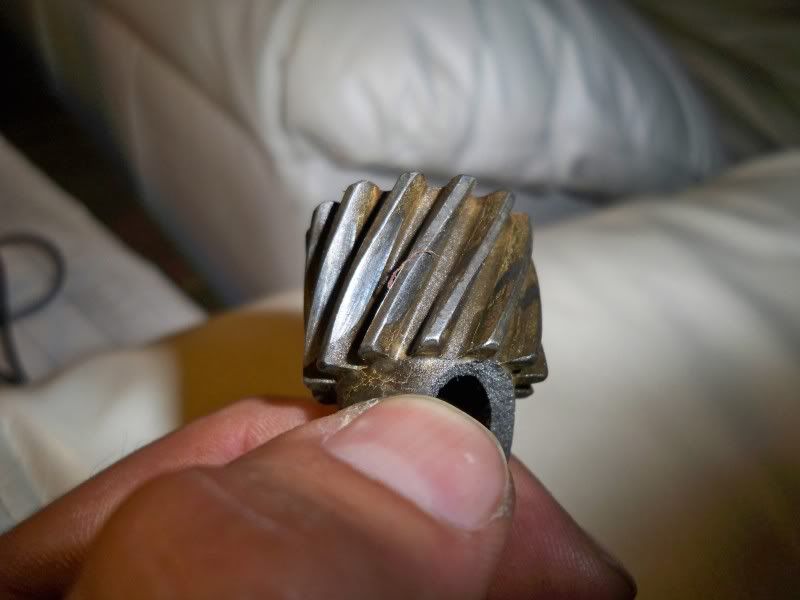

post #827 of 1825 Old 10-03-2010, 03:55 PM
Jp90Talon
Location: CT
Posts: 236
Finally got my camera back....here are the pics
Jp90Talon is offline
post #828 of 1825 Old 10-03-2010, 04:28 PM
solarpower
Join Date: Aug 2005
Location: Toledo Ohio
Posts: 1,422
Curious...those marks you see on the wrong side of the teeth (smaller wear marks on back side of gear) do they go all they way around?? are they consistent at 3:00 6:00 and 9:00 position if break is at 12:00??
the pin that you removed...is there any side to side wear (wallowed out) of the hole that remains in the gear??
that very much looks like a cast type steel that has suddenly cracked..I could be wrong and it could be a improperly hardened steel also.
04 TJ "U" package
06 XK Commaddy 4.7
solarpower is offline
post #829 of 1825 Old 10-03-2010, 05:22 PM
Jp90Talon
Location: CT
Posts: 236
They go all the way around and I didnt remove the pin. After the crack both the gear and pin dropped off the rod into the oil pan thus the loss off oil pressure.
post #830 of 1825 Old 10-04-2010, 12:13 PM
willydigger
Join Date: Nov 2005
Location: Baltimore
Posts: 1,574
What revision OPDA was it?
What oil were you/previous owner using?
What does your camshaft gear look like?
So it gave no symptoms and then the gear broke off? That's some scary stuff.
willydigger is offline
post #831 of 1825 Old 10-04-2010, 03:08 PM
Jp90Talon
Location: CT
Posts: 236
No clue but the part # is.....
P/N:53010624AC
105061-REV-B
No clue on previous owners but I was using regular 10W-30
My Jeep is my daily driver and I need it for work so I had to pay a shop to fix it. I was told it was a bit scuffed up but not all that bad. Runs great now after replacing the assembly
No symptoms at all. Actually drove it all the way up to NH w/o issue until I tossed the CELs and warning sounds due to the gear falling off and loosing oil pressure

I don't see how that gear and pin fell off the shaft or how the cam could have broken it.
It looks to me that it was broken either on installation or removal. If the gear rotated on the shaft neither hole would be intact. The gear can't fall off the shaft because it's trapped between the oil pump and the OPDA housing.
Something fishy me thinks...
Sweeney is offline
post #839 of 1825 Old 10-04-2010, 06:06 PM
Jp90Talon
Location: CT
Posts: 236
I didnt do the work but he put in a new one and its running fine now and the pics show what he gave back to me.
