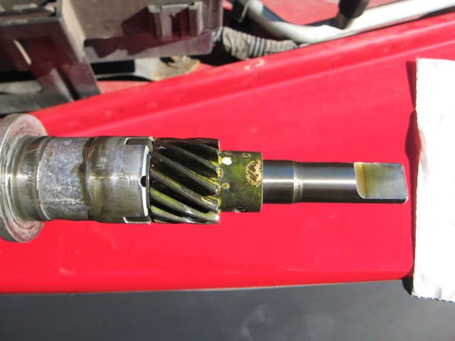

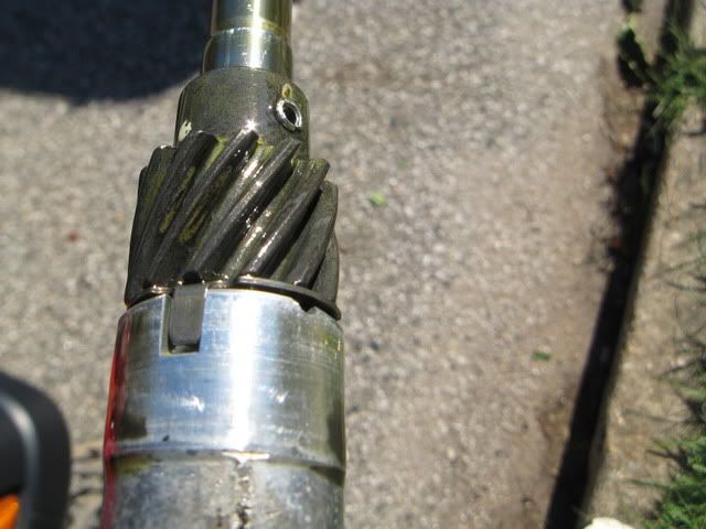

I picked up the gasket from the dealer that they failed to install with the new OPDA. I pulled the OPDA with about 400 miles. There are normal wear marks on the new gear. The stem was doused in oil.
