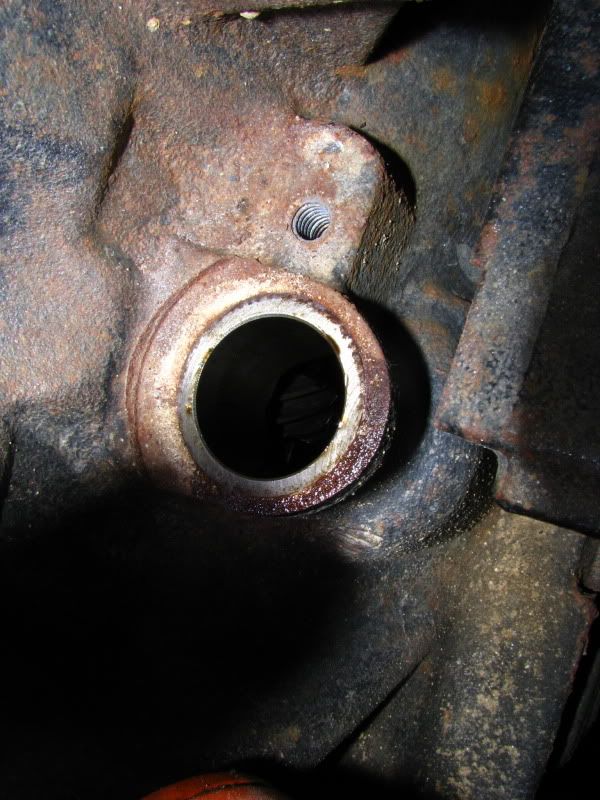

So I got mine out and took some pics:
That was the best picture I could get from the camshaft gear, but looking at it with a pretty bright flashlight I couldn't see much damage.
So at 54,000 miles it appears mine isn't nearly as bad as some of the ones I've seen with much fewer miles, but the wear is definitely abnormal. Guess I'll go post in the registry thread now.
I'm still within 7 years/70k miles but I'm the second owner. I'm mailing the transfer form to the guy I bought it from to have him sign it. Good thing I found that, it says it can only be done at the time the vehicle is sold...just bought it two weeks ago, haven't even tagged it yet.
Joe
