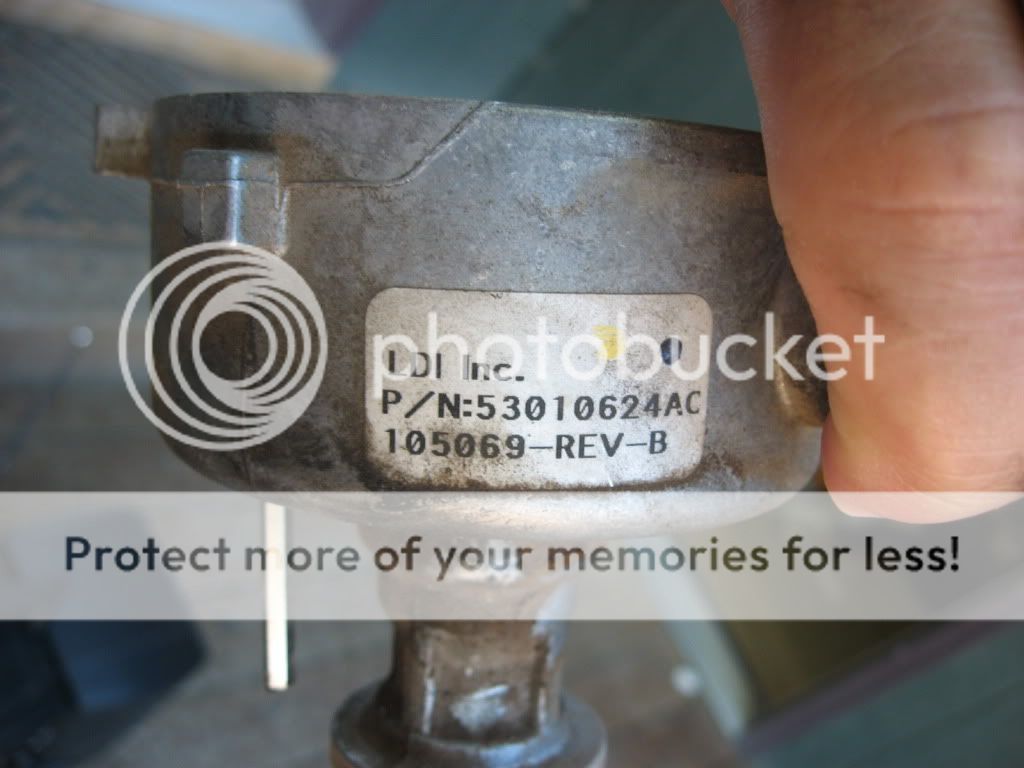

Originally Posted by Sccafire View Post
I circled the Camshaft Position Sensor Date Code Label. On the second row of numbers the first 4 numbers are the date code. if your numbers are between 4297 and 4364 the TSB EO5R will pertain to you. If your numbers are lower than 4297 or higher than 4364 you will not need replacement. This is according to Alldata that I have for my 2005 TJ. You may not have to remove it to see the label. Try using a small mirror to read it.
your picture isn't showing up anymore, hoping you can confirm something for me.
My sticker contains the following info:
LDI, Inc.
P/N: 53010624AC
105075 Rev B
So the first four digits are 1050...which is quite before the 4000-range numbers you suggested. Am I looking at the right number?
My LJ was built April 05 and the engine was built in March. 503MX.54,000 miles and no drivability issues.
LDI, Inc.
P/N: 53010624AC
105075 Rev B
Believe that's the 75th day of 2005, Mar 16th.

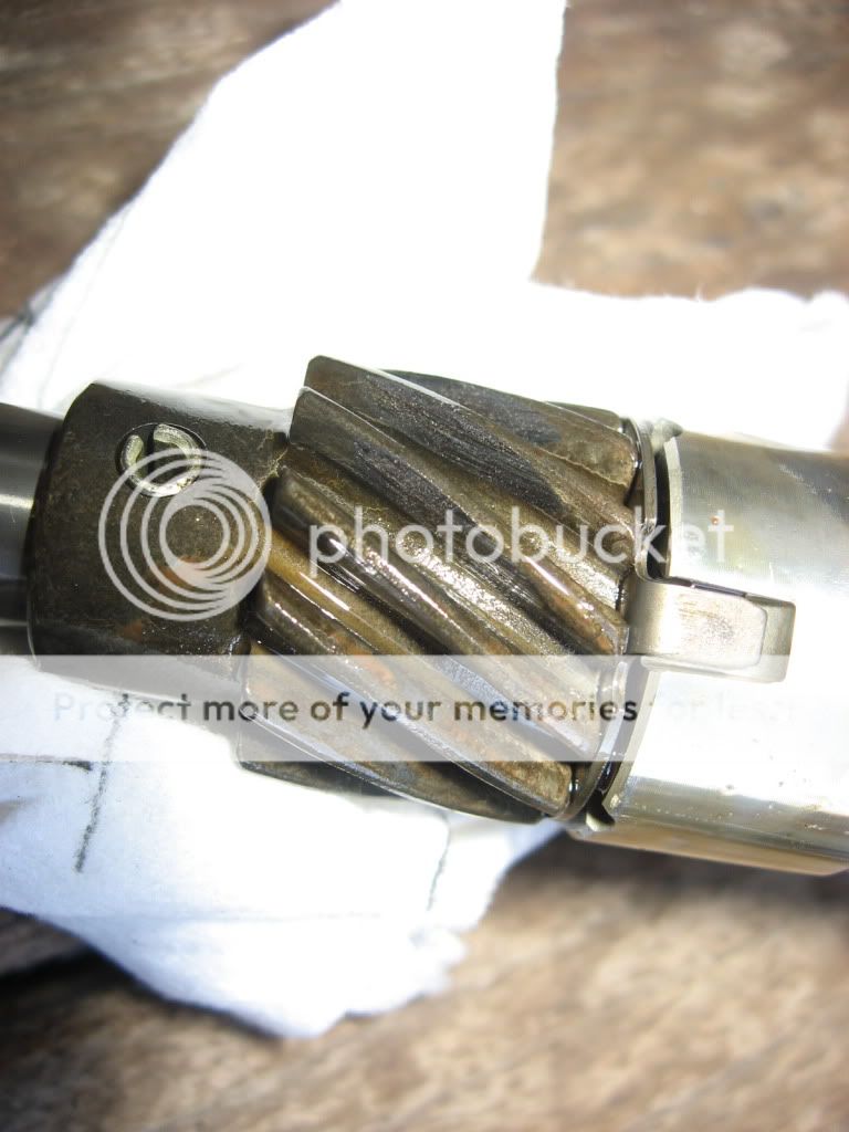

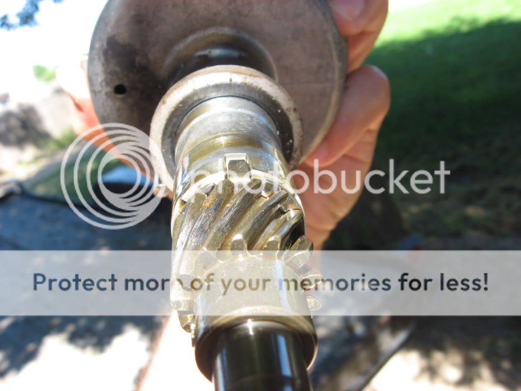

Opinions? I would tend to believe that this wear is a little premature for 27,000 miles. I apologize, the pics aren't the best, but I hope they are good enough for opinions. From the markings on the OPDA/CPS it appears that it has been checked a couple times, but it still doesn't seem right to me....
Date of Manufacture: 04/05
TIA
speed_phreak is offline
post #463 of 1825 Old 08-09-2010, 10:15 PM
anymanusa
Location: Beautiful South
Posts: 336
Yes speed freak, you definitely have the problem.
so it sounds like in the post I quoted it should have said the last 4 numbers instead of the first four.
So between 4297 and 4364 would be from the 297th to the 394th day of 2004.
But then speed phreaks definitely looks like accelerated wear and it appears his was built 6 days before mine.
Guess I'll be pulling mine out tomorrow for inspection.
