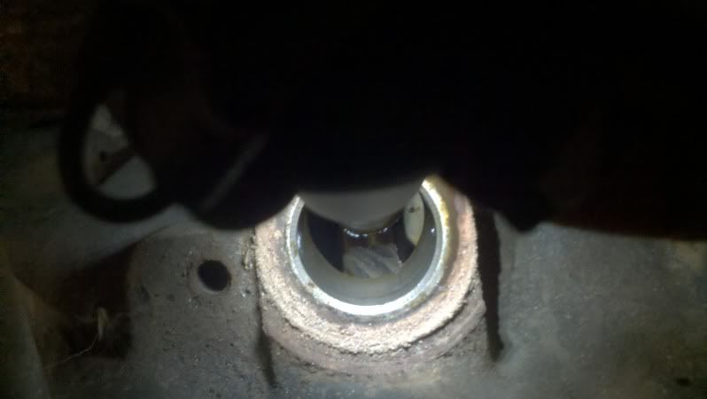

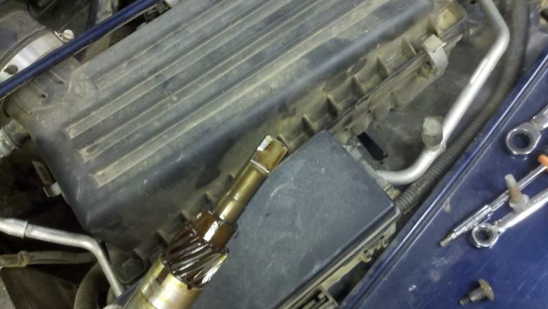

Ok. Picked up the replacement package....a new bottom gear, flange, gasket, rod...and a one-time drill bit to drill the gear?? and install. Pretty laughable..but it may work. Took it to a machine shop recommended by my buddies down at Jeeps R Us and they are going to re-work the shaft, check and re-grease/replace the bearings, and put it all together again good as new. I'll pick it up in the morning and give it a shot. Best option now given price of a new engine etc....I'm going to put myself on the waiting list for the part just in case (and to have a spare). I'll let you guys know how this works out once it's back in and running.
They did take a look at the plug location and the hole seems to end abruptly at the casing for the bearings, so there seems to be no direct route to greasing the bearings by using a zerk fitting unless you were to drill through the casing a bit, and they weren't crazy about that idea. Fog? Any input?
Took a look at the 2003 setups and compared them to ours today to try and get some ideas for future workarounds, but I'm thinking that fixing this one and then checking it occasionally might be enough at the moment....and then either rebuilding or receiving a backup part for any future issues.
I'll update you guys tomorrow on the progress. Cross your fingers!

My Jeep is up and running again and better than new. I'm gathering some info from previous posts, talking to a couple of folks on here who've been working on this for a while now, and typing up a summary of suggestions and what I did and how I did it.
Bottom line....replacement gear from Chrsyler...$32.....machine shop to polish the shaft of the distributor oil pump and install the new gear etc etc...$40...oil change to diesel oil...$25 or so...I"m out the door less than $100 and three days downtime.
Chrysler is NOT going to take care of this anytime soon, so we need to make it happen. Thanks to all the previous posters who shared enough info to help me get it done. I'll get my summary up today or tomorrow so that others can get things going too.

Ok...here's my experience and the information I was able to gather over the last few days....I had the chattering monkey syndrome, pulled the CPS, had some unusual wear that was just starting on the gear and some markings that needed to be smoothed and polish off of the shaft by a machine shop. The shaft and bearing were fine. Re-greased, re-installed, and we'll check up on it in a couple of months, but it is running great and seems to be better than new....all for a total cost of $72.
Here are my ideas and notes to add to what has been posted before. Thanks to all of you who have been posting to this for your ideas and help in getting this resolved...at least for now:
Check your gearing using the instructions in this thread. If you have a problem (even if it's making the chattering monkey sound), contact Chrysler to get a case number so you can add to their embarrassment and data base:
Contact Us by Telephone:
1-800-853-1403
M-F 8:00A.M. - 5:00P.M.
(U.S. Continental Time Zones
Since they probably won't/can't help you without a part, here are your options at this point:
Option #1: Part number: 53010624AC Distributor Oil Pump ($112-150 from a dealer or from:
Jeep OEM Parts
Jeep OEM Parts
Mopar Parts for Dodge, Chrysler and Jeep: MoparPartsAmerica
This part is back-ordered in the US/Canada/everywhere else. The number of back-orders was 237 as of 8/5/10. The companies listed above will let you order them, but you will receive an Indefinite Backorder Email within a day or two saying that they have no determined date for delivery. You may want to get on this list to have a backup in case they ever DO fix it.
Option #2: Repair package part number: CDC0E51AB $32
Chrysler did send out a Replacement/Repair package in 05 to their dealers to deal with this issue. The part number above consists of a kit that contains the bottom gear, a new gasket, a brass mounting flange, a mounting pin to hold the gear to the shaft, and a one-time drill bit to drill out the mounting hole on the new gear. (My gear already had two holes opposite of each other to use and they thought the drilling option was idiotic at best..
Take this kit and your old part to a machine shop, have them polish the shaft and install the new gear and check/replace the upper sealed bearing, and you will be good as new.
My guy did mine for $40 total. The bearing was in great shape, so they cleaned up the shaft, greased up the bearings again, put it all together, and we're good to go.
Option #3: Order the gear itself from the following vendors.
4WD Hardware: BOTTOM GEAR - RETAIL:
Distributor Drive Gear by Crown Automotive and Other Jeep Parts and Jeep Accessories by 4 Wheel Drive Hardware-RH3
Crown Automotive (BOTTOM GEAR - WHOLESALE):
Distributor Gear (2.5L, 4.0L) | Crown Automotive Sales
Part #83504635
Option #4: Buy or find a 99-04 CPS unit from EBAY or a junkyard for like 20 bucks and pull the gear of it.
You will also need to order the gasket for any of the options above (minus the Chrysler repair kit as it already has one included). The part number from Chrysler is J3181288. (I'm pretty sure that the gaskets from a 2002-2003 distributor oil pump would work too since they seem to have the same base. It's a flat, fiber, round gasket that fits around the base of the assembly, so you could probably find a substitute by trial and error at your local auto parts dealer.)
I did talk to my machinist about installing a zerk fitting to lube the bearings, BUT my 2006 model had a sealed bearing assembly and the location of the zerk would have led to nothing but a dead end. It seems Chrysler may have made some adjustments to the manufacturing process after 05, but I'm not positive about this. My Jeep was build on 12/05 and I still had the chattering monkey syndrome and unusual wear on the gear and binding on the shaft.
That's all I have for now. Post or PM me if you have any questions, and I'll keep you posted as this moves along.
