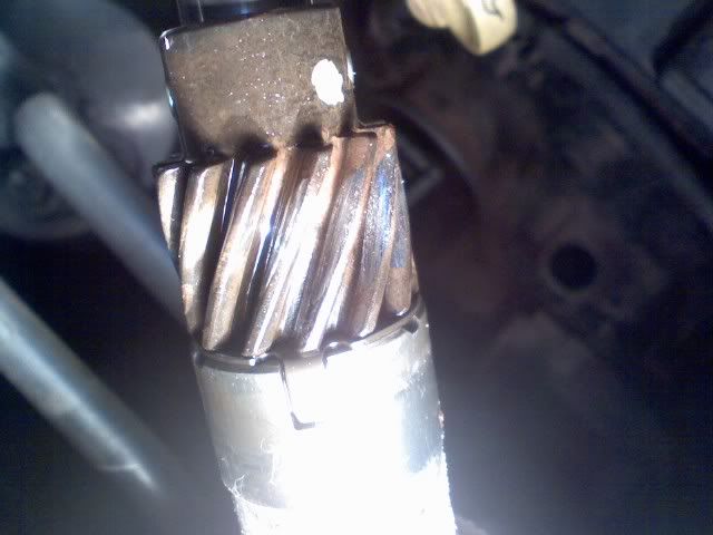

posting again. What do yall think of the wear? Got everything buttoned down and she purs like a kitten (well a BIG kitten ahah) no codes or anything. Sorry for the ****ty pic, my cell is all i had, you can look at the right side of the gear to see.
I have about 50,000 miles on my Jeep.
Well you didn't post a really good close up nor did you post pics from different angles. That being said the wear marks on the gear are too long and there are visible striations.
What this means is that normally there is very small peak/contact area on the CPS assembly gear and the crankshaft. But as that small peaks wear down it allows more of the gear surface to contact the camshaft gear.
As the CPS gear gets worn down it allows clearance to increase between it and the gear on the camshaft. As the edges of the camshaft gear slide off the CPS gear you get the vertical striations.
Here is how much surface should be worn down on the CPS gear. Notice the smoothness of the polished contact area and the length of it.
Now here is a picture of what uneven excessive wear looks like. Notice the contact area is much larger and almost twice the size of the normal contact area. Also note the striations and the unpolished worn look.
IMHO your gear is showing increased wear and I would replace the assembly soon.
I think I might take it higher up if I start having issues.
Right now all you have is some wear on a gear, if you let it go till you start having issues then you will have significant engine damage.
Once the wear on the CPS gear has worn down to the point of causing noticeable issues, its damaged the camshaft gear which requires you to either pull off the front of the Jeep to pull out the camshaft or pull the engine to get access to replace the camshaft.
My advice is to get on the phone and call around and find a dealership with a replacement CPS assembly in stock. I know its a crappy deal having to eat $150 for something they screwed up on but its allot less agrivation then engine damage and fighting tooth and nail.
FOG
Only 150 bucks? That's not too bad. But wouldn't I need to replace the cam as well since it would have similar wear? Or was it the OPDA thats just needing replaced?
It all depends on the wear of the CPS/OPDA assembly. From the amount shown in your pictures IMHO has not gotten bad enough to start to harm the camshaft.
That being said when you go to install a new CPS/OPDA assembly shine a light inside the engine block and take a good hard look at the camshaft gear. What your looking for is disfigurement or excessive wear on the edges of the gear.
ROADKILL- There are some dealerships that still have them in stock but you have to really burn up the phone to find them. To make this allot easier don't ask them for a CPS or OPDA. Instead find the part number (its in this thread) and ask them to check stock for a part number. I did this and I found one in about 20 minutes.
