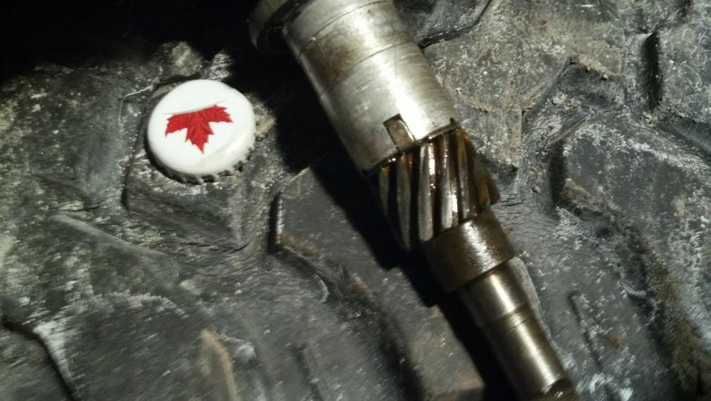

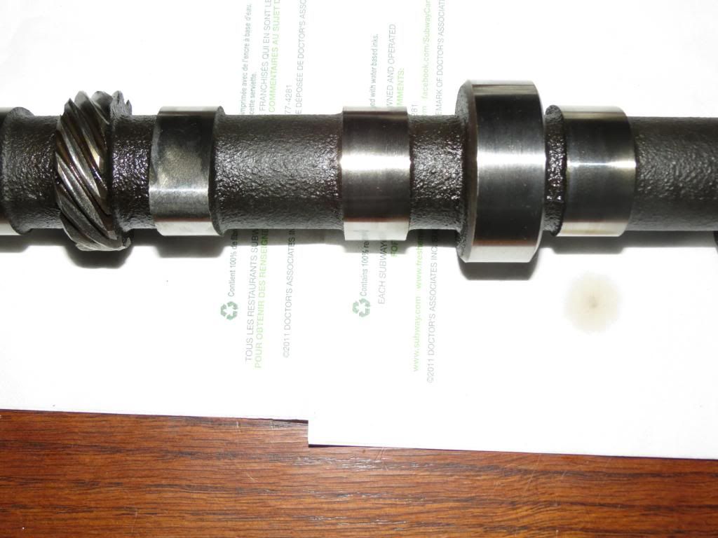

Im not sure if I have the exact same problem, my opda is worn similar to others but my original problem was that the distributor was forced up by the opda and broke the hold down tab. so should I order new camshaft and distributor or could it be something else?

Thought the problem was unique to 4.0L (?)

Any distributer not properly aligned can cause knife edging and other problems. The 05-06 problem is that plus lack of lubrication on the shaft

I pulled mine for the hell of it the other day and the gear was worn bad and the end of the shaft was worn as well just replace it. I bought a Dorman replacement part from O'Reillys for 132 and some change. I'm sure the cam gear is worn too.

All owners of the late model TJs, all, IMO, should immediately remove the original OEM part and replace it now with either the Dorman or the new Crown unit.
The misalignment that aggravates the issue is a result of the shaft wearing into the bushings (if you want to call them that) and then offsetting. The basic issue is no lubrication and the shaft seizing, dragging which also accelerates wear.
I just did my 06. The cam shows what I consider normal wear, the OPDA gear was slightly more than normal but the shaft was very hard to rotate, stiff. It would have not been much longer before the bushings that support it egged out and allowed the parts to misalign, offset. A CIL would then follow if not worse.
ALL 05 and 06 TJ need new OPDAs now. You must change them out NOW. That is my opinion based now on several observations and my 30 plus years as a mechanic of various sorts and now looking at this issue. Do it now. You must do this change.
I would get the new Crown part, the Dorman is what I installed.
