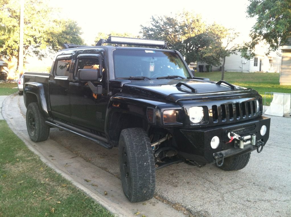

We went to a Jeep dealer yesterday and they just blew us off and said to call Chrysler. I'm not to happy with them at all, 2 weekends ago I ripped my CV axle on an off road trip in my H3T and still under warranty. GM knew what I was doing and when they saw my truck they knew what it's made for, fully covered the flatbed and the CV axle with no charge. I really enjoy Jeeps and one day I would like a scrambler hell even the JK8 kit would be great but with happening to my buddy IDK. At the same dealer I checked out the only JK8 they had and you could see the 4th door outline clear as day and sticker price was $50,XXX. Hope you guys don't mind me posting a photo of my T.
Thanks for the info and I'll keep you guys posted from down range with what's going on with his Jeep.
