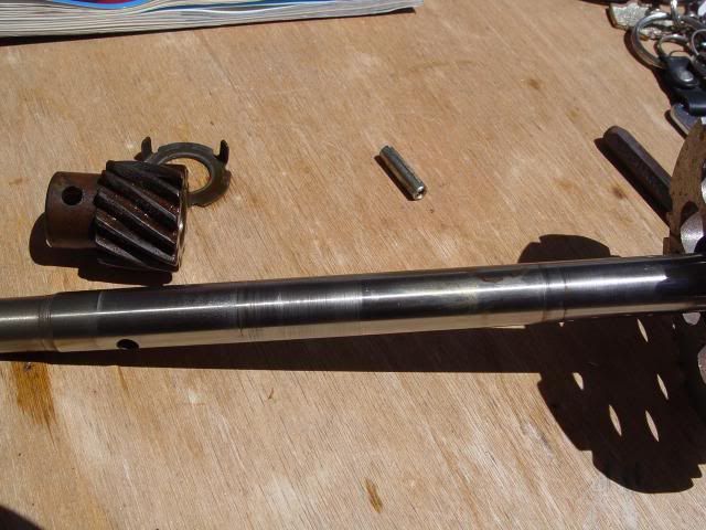

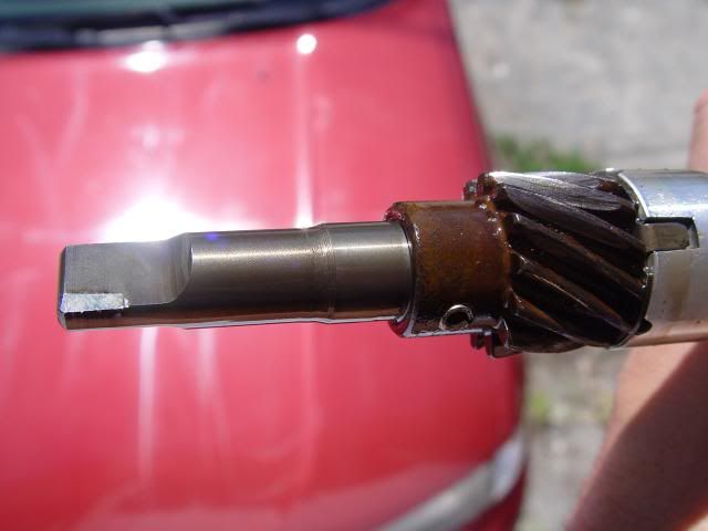

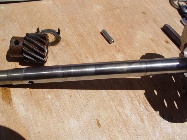

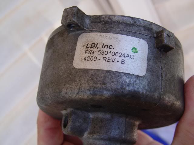

OK, I took out the OPDA and took some pics, really need opinions on this:
The OPDA shaft looks fine, its got some scoring, but you can barely feel it when you run your hand over it. The gear itself on the shaft though, looks worn. The camshaft itself in the engine looks "OK" its got a bit of wear showing, but its nowhere near as bad as the gear on the OPDA shaft. The engine has 87k on it, I already sent the head out for a cleaning/valvejob/resurfacing.....which is gonna cost me around $250. So the question is, what should I do about the OPDA? Pics below. Also, based on honest recommendations where is the cheapest place to pick the needed parts up FAST? I get the head back on Wed., like to have the engine buttoned up by friday the latest. Thanks in advance for helping out a new Jeep enthusiast!
