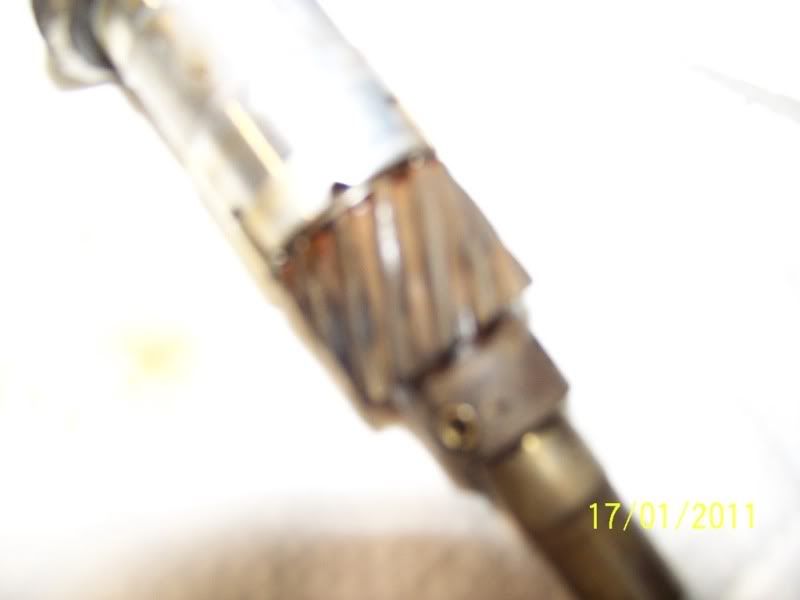

Here's my blurry pic the dealer took, of course they diagnosed it as nothing being wrong with it. I'm not stupid and can see some wear on the gear even in this blurry a$$ picture. 28,000 miles
I'm hoping the OPDAs are available soon so I can get this taken care of. Not a fun feeling knowing you're driving a ticking time bomb.

ChaseB, Too bad the pic isn't better. Can't tell the wear from that pic.
I hope they're better mechanics than photographers. That picture isn't much good for you. They probably wanted it that way, hide the evidence.
lope is offline

Posts: 1,593
I requested to be there to take my own pics but you know how that goes.....RUNAROUND.
In any case I finally spoke with someone today and as already mentioned expected ETA on OPDA units is February 14th. Be mine OPDA lol
I'll try and pull it myself soon and take some actual photos and not blurry nonsense
I think that if it were bad you'd see more shine. All I see is some discoloration. Either way I don't think you'd have very bad wear at 28K.
Get the mod done though.
