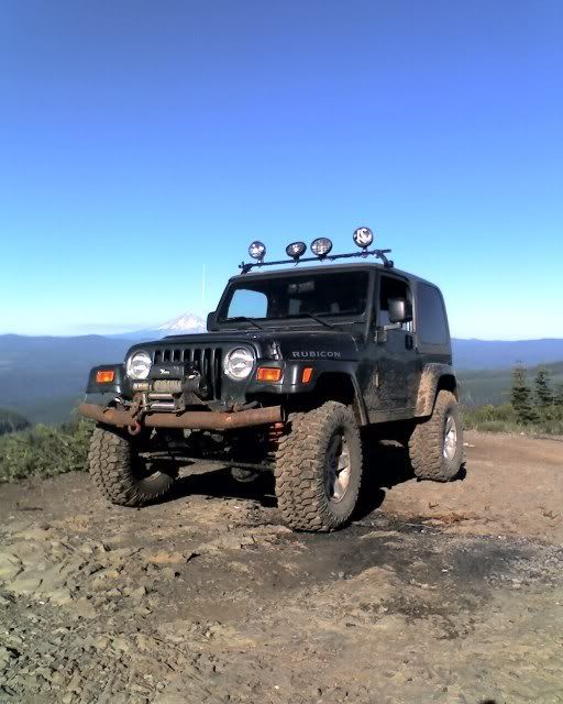

here ya go, 33x12.5x15 on a "2BB and "1BL with 15x8 rims 3.75bs

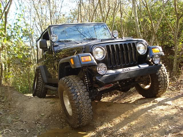

i use different springs than you are planning on, and my body lift is a quarter inch smaller than you have, so i only have a 1/4" more lift than you are planning on (+ 3/4" spacers in front, just to level it out a little) and i am happy with the way my 33's fit. i am not sure how much backspacing the ravine's have (it is around 6" or so) but i use spidertrax spacers and they fit fine.

sweet pics, thanks

Posts: 5,999
2.5" rancho on 34" trXus..
