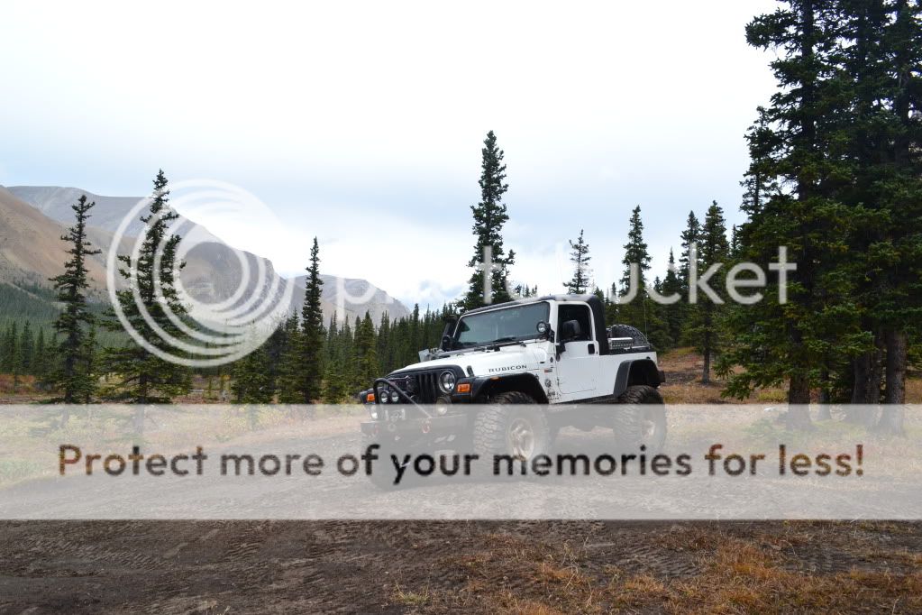

Myself and 5 others in our group are all running 37's on our LJ's all are Rubicons. And all but myself are running stock shafts. Mine tossed a u-joint cap and broke the stub shaft and beat the H*** out of the short side yoke at highway speeds. So i up graded to RCV D44 axle shafts.
We have pretty much a mud up to the windows or Rock and a lot of both on every trip. at least 1 a month, and if the stars line up right we get in 2 trips. and there is a ton of taunting to challenge each other to the extreme. with no problems. There are ways to add strength to the axles if needed for your type of wheeling. But i would not worrie about it. Under the right cirumstances anything will break.
Built not bought!!!
2005 Rubicon Unlimited, 5.5 inch custom long arm, 1 inch daystar body lift, River Raider Snorkel, Custom bumper/winch mount, sliders, tire carrier. 37x13.50 R17 Nitto Mudgraplers, Bushwacker flat fender. Custom 1/2 cab. Hyline hood vents. Custom tonnue cover and tool box. HID-X off road lights, LED driving lights custom rear bumper/m6000 rear monted winch.
