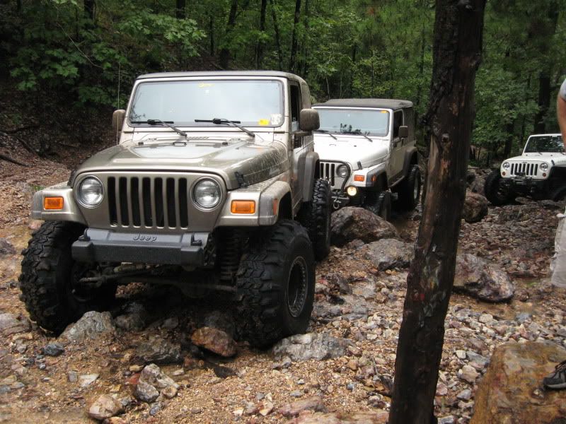

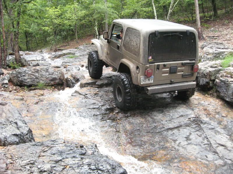

How bout 38s on a good 'ole D30? This guy had a nice D60 rear axle, but had a D30 up front with a sleeved OEM tie rod and regular drag link. Stock brakes too IIRC. Let me tell you he was REALLY soft on the skinny. Never gave it any gas ever. Rightly so as if he did, his front axle would blow up. It was stormy that day and all the rain made the trails twice as slick. That said, he never needed to winch the entire day and out wheeled me (at the time with 33s) and the Rubi JK behind me on 37s. I think the D30 was just temporary until he could get something better (or at least I hope so).

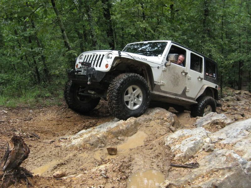

4 Door JK Rubi on 37s
