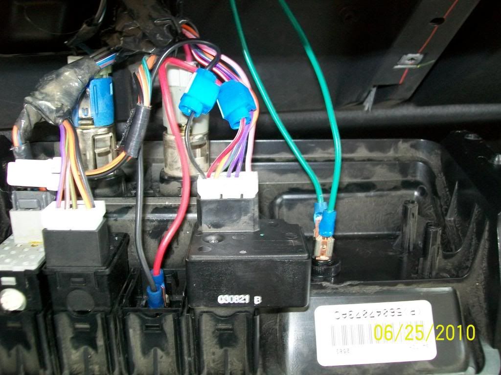

so just finished the rubi locker mod and the a/c off mod.

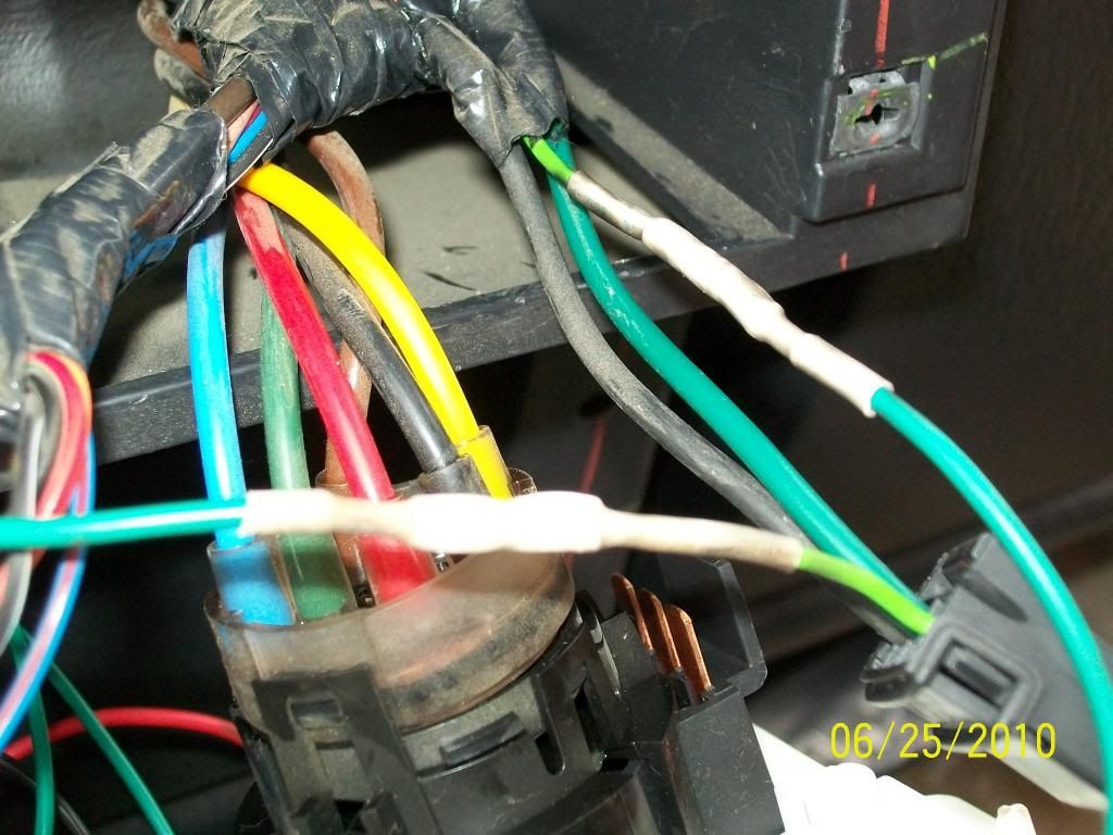

Here is the locker mod i spliced into the red wire with white stripe and the solid black wire
heres the A/C mod the wire is located on the far right of the heater control panel, its the top lime green wire and its the smalls out of the 3

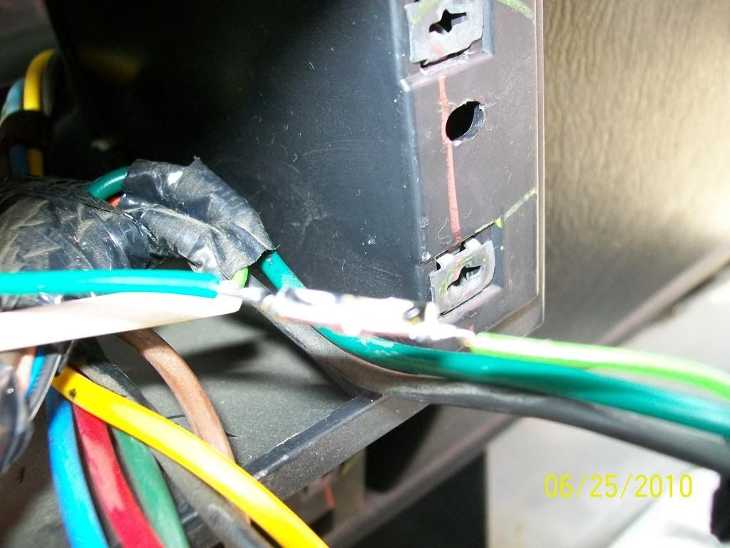

i ground off the plastic on a wire connector and crimped the wires together and soldered the ends of the wire connector
then after soldering both wires i shrink wrapped them
