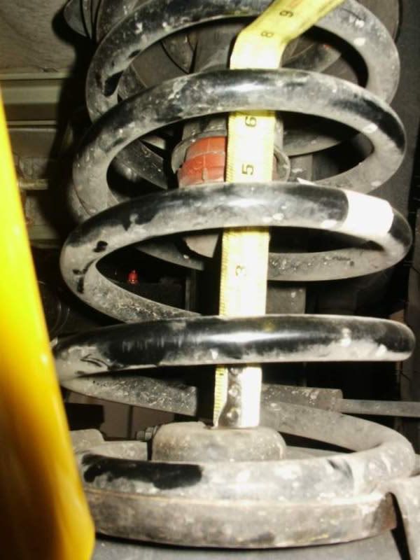

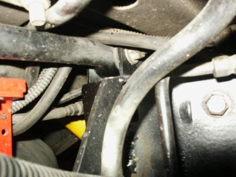

Originally Posted by mudb8 View Post
Since you are pointing fingers... measure first, then tell me I don't know what I'm talking about. I'm sorry you can't get past the rear steer you gave your self with 3" uptravel, 8" downtravel and can't figure out how to compensate for it or adjust the anti squat.
a stock TJ rides like crap, thats a fact compared to mine, not an Opinion and has 4" uptravel after you compress the rubber bumpstop to nothing..
My cobbled together crap spends alot of time over 60mph + through ditches, on dunes and washboard terrain not to mention takes rock gardens way above a crawl due to my decade old short arm, 14" travel suspension. I'd love to see you try to keep up, then drive it like a car in the curves on the way home. 6" of uptravel not only soaks up bumps, it lets the suspension cycle further before lifting the frame on an obstacle.
In the end, my back doesn't hurt and I still have more ballanced and useable flex than the "New" version of "old" crap and I still have Track Bars.
Theres a TJ with LA's sitting next to my Tj right now, anyone care to see which one rides better? You're more than welcome to stop by anytime, I have a kidney belt for you to Put on before we test drive the Long arm...
exactly how does my "cobbled together" jeep have anything to do with this thread anyhow?
Jerry or wheelin, how bout keeping this Know It All Clown from cluttering up the thread with BS.
I wonder what I was doing when I took these pics, besides eliminating a track bar extension that put it into the tub? Theres a 10" travel shock with 5.25" uptravel on the 2.5" lift with a 3/4" bumpstop extensions there... I wonder how that fits? all that arc and the stop nearly lands flat on the pad... hmmm.
or these.... that already have 2" bumpstop extensions with 5.75" available and useable uptravel, yet the 14.5" collapsed shock length has a whopping 2.75" of uptravel, some of which is due to the tera shock shifters. The pinion angle is also jacked up due to a SYE and a Rokmen belly up skid, which tips the mounts down in favor of uptravel.
Tell me again what the angle/arc of the arm has to do measuring bumpstops... I've already checked and checked, and checked and checked again and came up with a simple solution.
i was talking about shock/arm angle effecting desired shock length. you have time, check again. your examples listed suck as its clearly apples to oranges with too many variables involved. your cut and paste calcs wont work.
tell us exactly how the average bolt-on wheeler reading this is going to achieve your supposed ideal suspension travel?
if your rear suspension is consistently bottoming out with 4" coils and 2 bumpstops, then you have too much weight in the rear, weak coils, too stupid to measure for shocks or just drive like a (I avoided the language filter and received this warning).
strange you knew my old suspension travel? i didnt. the rear steer it did have was due to running short 26" lowers with a upper triangulated configuration. not hard to figure out. its all gone though as ive since completely gutted and upgraded the jeep.
to the contrary, youve been running the same pos suspension for years and haven't upgraded. you then base all of your opinions off of the assumption that your jeep's suspension is superior to everything you work on, drive by, or cant have. you consistently run the same bs in every thread stating you must have x amount of uptravel or youll need a kidney belt. very dramatic. as an example, you offer pics of a RC kit that is known to have the wrong length shocks. theres pages of bandwidth dedicated to the topic.
ive called you out far worse in the past. i havent had one issue with a mod on this board, or any board i frequent. besides, this thread took a dirtnap months ago and had to be resurrected just to see you get mad and start calling names. priceless

Originally Posted by Jeepzcb09 View Post
I have a 4in RC "X" kit. What should i do about bumpstops? Should i just buy some pucks a put them on the spring perch? I do have ba 2in BB laying around
put the fronts on the spring perch, and the rears on the upper bumpstop tower... measure at ride height and match distance of the spring pad and the bumpstop tower to the uptravel of the shock.
Originally Posted by atxzj View Post
Is it installed? If it is, and you have access to tools, i would yank the coils and start measuring. If not, put the kit on minus the coils, and compress the wheels until it rubs, turn it, back it off and take some shock and bumpstop measurements.
As said before, there are far too many variables for anyone on the net to tell you to just install X amount of bumpstop or shock and be done with it. The best thing you can do is crawl under there and start figuring out how to handle these issues now, and in the future.
LOL, you still don't get it. bumpstop length can be measured without fooling around or pulling springs and the above chart also shows the minimum amount of bumpstop length for a tire size to keep them from rearanging sheet metal, I don't care about rubbing fender flares.
I already did all the testing over the years with thousands of Mods and installs I've done and took into account all the variables you can't wrap your head around including the angles and Track Bar interference.
lets say you are using 32" tires with a 2.5" lift and have front shocks that are 16" collapsed, you need 1" stops for the tires to clear and 2.5" bumstop extensions to keep the front shocks from bottoming out.
The "Fuzzy points", since you don't get it, are the different shock extended and collaplsed lengths with the same or less travel. for example,
OME N66L shocks are 15.5" collapsed and 26.5" extended... 11" travel..
Rancho 9000 rs999255 shocks are 15.875" collapsed and 25.875" extended... 10" travel.
Or an 11" travel Bilstein that has a 17" collapsed length and a 28" extended length....
SO, for those looking for a good ride and best flex, are best off to use the shortest collapsed length with longer travel that requires less bumpstop extension, The Bilstien, stuck in stock mounts will literally stink due to the length.... Thats all fact, not my Opinion. I put things together properly that work and perform best. For those that are putting on 35's and need 3" bumpstop extensions, the Variables switch gears allowing the use a longer collapsed length shock, just because it'll fit the application but will not ride as well due to the reduced suspension uptravel, the other problem is the shocks allow the axle to droop beyond the uncompressed length of the spring and is basicly unuseable. That extra droop causes extreme angles with Short Arm/Mid arms and Contributes to extreme rear steer due to unbalanced travel.
