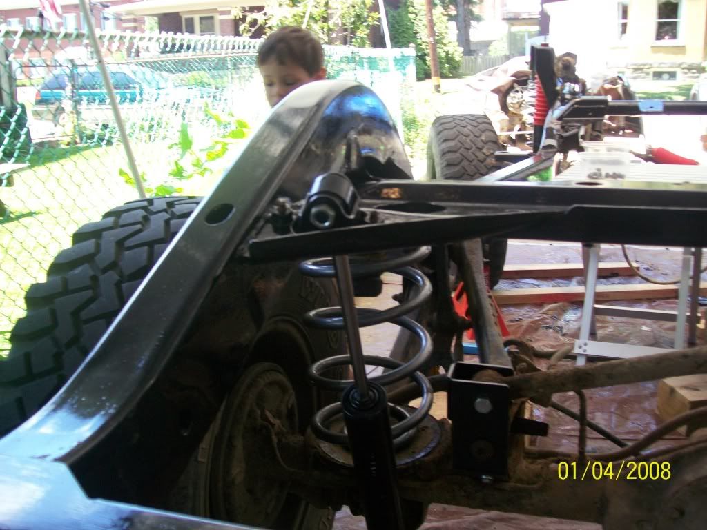

this is how a BL can help with shock length/bumpstop.....
with the body raised the rear upper mount can come up through the factory hole 1" reducing the required bumpstop length by 1".
1" is all you can get away with tho.

Hey nice pic!

IF you had a BL then you could run the Tera uppers in the pic above and not have to change your BS's at all.

So is that pic by Mud8 showing the terra upper mount? If so, does anyone know if it fits ranch 9k shocks. I'm way over due for new shocks and would like to know if it that mount would fit and articulate fine. I guess I'd have to find the equivalent Ranch # for a non bar-pin style shock if it works? 1" would be great for me.

Yeah the pic is of the Tera relocators. You have to run at least a 1" BL to run the relocators. In the pic mud posted I had to grind the "washer" off the skyjacker shock body that the dust boot hooks to so that the shock could move freely around the inside of th bracket.
IDK about the Rancho's but I just ordered Skyjacker Hydros for a 4" TJ lift and put the bushings in but not the bar pins. It is nice to have the extra 1" of uptravel from a BOLT ON bracket.
