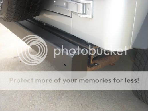

The Mopar (Jeep) end caps look like this. I forgot the part numbers, but if you order them from a Jeep dealer, the parts guy may not know what you are talking about so tell him that they are for an "06 X" model TJ. Only Jeep they came on stock from the factory.
I bought mine at www.moparpartsamerica.com. They are listing them for $2.69 each for front and $6.88 each for rear. I used same hardware that was holding milk jugs on to put these on.
Call and ordered them through local Jeep dealer, 3.50 a piece... I have an '04 Wrangler, he was telling me they were only for the '06, but I imagine the bumpers are identical or close enough to alter...

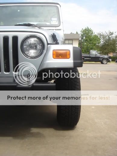

great thread, I left the rear milk jugs on but the front ones were the first thing to come of when I bought my jeep. I am glad that I read this thread because closing it off will look better. Now I just need to figure out how to straighten one end, it was bent a little when I bought the Jeep
My plan this weekend is to trim about 1-2 inches off each side of the front bumper with a grinder, then drill new holes to attach the end caps, giving me more clearance up front.
Looks great austin...gives it a much cleaner look. Now put like 8 m80s in those milk jugs haha
