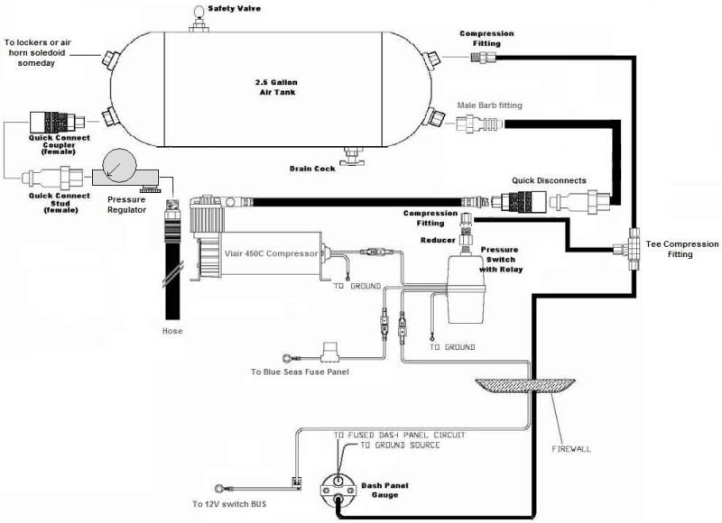

So I finalized my hose and wire routing for the OBA system and bought a few specialty items to make the job go quicker/easier: all brass pressure regulator, a compression fitting tee, and some assorted barb fitting & clamps.
I stole the schematic from Viair's documentation and altered it to reflect how my system is going to be ... install should start tomorrow night into the rest of the week (realize there's going to be some hose between the tank and the regulator ... I just don't know where/how I'm going to mount it yet):

It's in!! No pictures though I injured my back last week so I'm moving at an even slower pace (if that's even possible).
Got the compressor on the tray (with the pressure switch), and it's bolted down in the engine bay! The tank isn't in yet, but all the air lines are run back to where it'll be. I'm going to the PA Jeep show this Saturday, so I hope I'll have everything in by then.
I also plumbed the lines from where the tank will be, to the compression tee (3-way) fitting which branches two lines out: one into the cab for the pressure gauge, and the other to the pressure switch.
