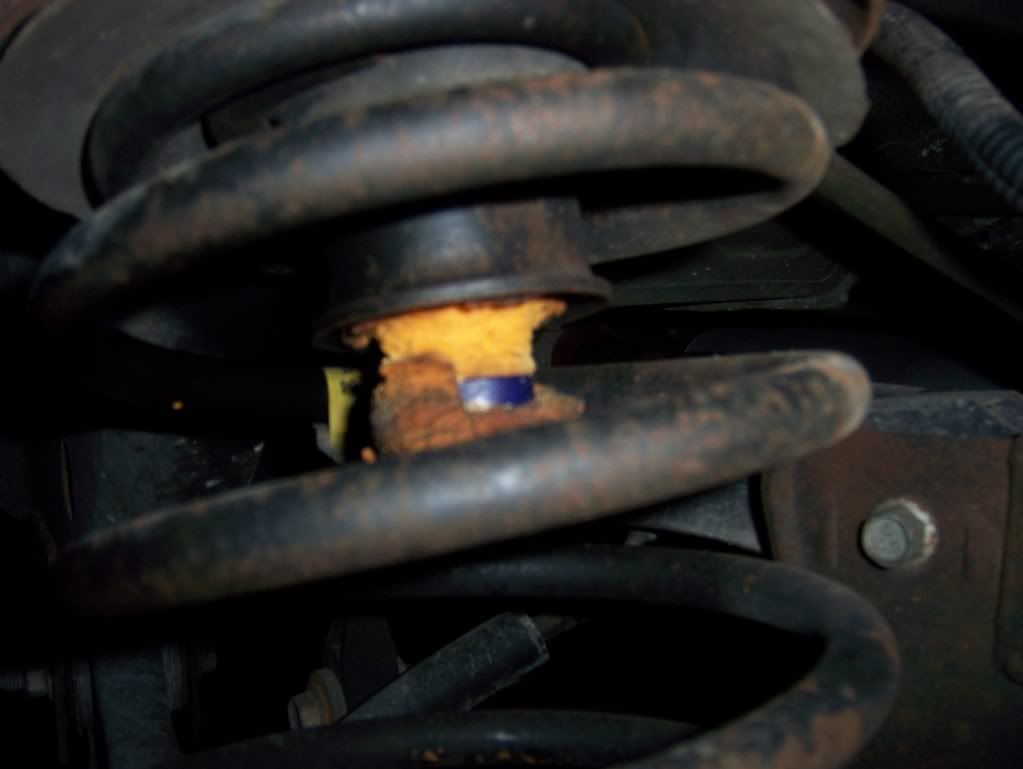

I am putting in my rough country 2.5 progressive lift and have noticed that my stock bump stops look worn all around the sides. It looks like they are a yellow material (looks like foam) under the black and have chipped off in places. Will they be ok? This particuliar lift does not require any adjustment of the bump stops or any mod parts. Any suggestions?

I did not start yet, I pb blasted everything today. I am thinking of starting tomorrow. Here is what my front drivers side looks like. What do you think? Is the black part above the yellow spongy part the actual bump stop?

and to follow up, the yellow "spongy" part is the bumpstop, and the rest is the mount for the bumpstop to make sure that it is at proper height for the stock suspension. It also acts as a nifty spring retainer when you upgrade your arms and can flex to the point of being able to have the springs hang loose

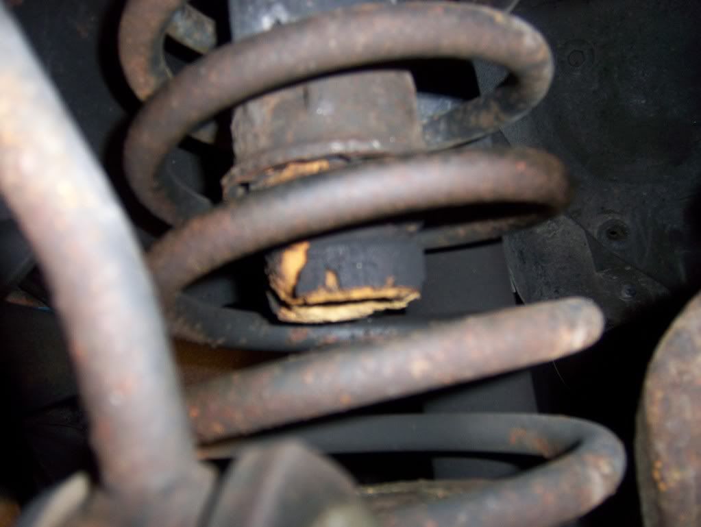

Thanks for all the info guys, so here is my rear drivers side. If I add extensions, do they go with these factory ones? This one looks pretty bad huh? Is it usable at this point?

I would consider replacing them...something like these may be the best to use in front: Rubicon Express 1.5" Extended Upper Bump Stops
And these for the rear: Jeep TJ Rear Bumpstop Extension Kit With these you will need to replace the stock bumpstop also. They fit between the frame and the retainer cup.

the nasty thing in the above pics is called the jounce bumper. its a compressible rubber "bumper" that cushions/slows the impact of the tower slamming into the spring perch.
just go to the pick-n-pull junkyard. ZJ fronts will fit in the TJ rear. and XJ fronts will fit in the TJ front. $20 tops. Last time I went, I walked out with 8 bumpers for playing with
