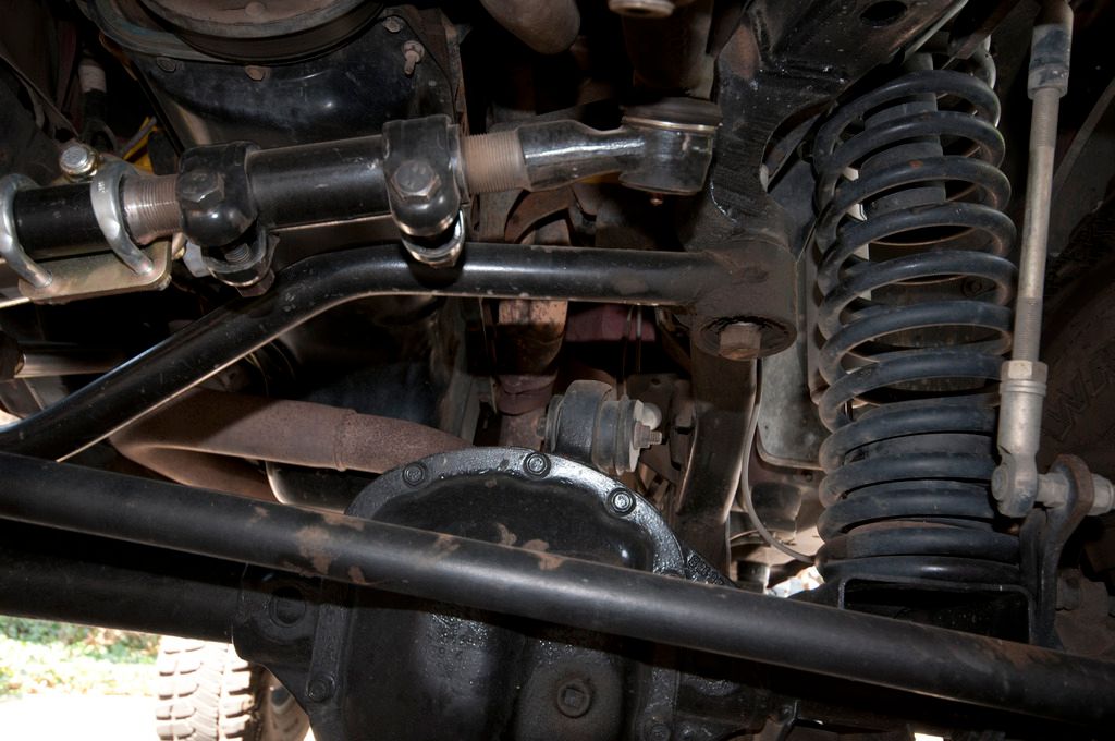

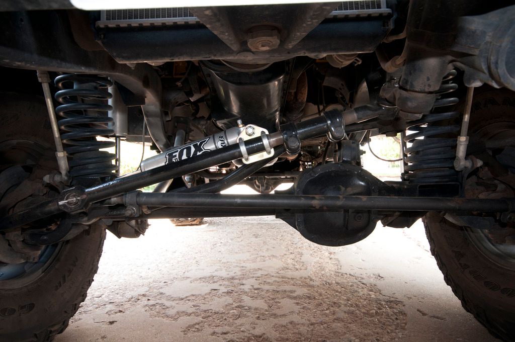

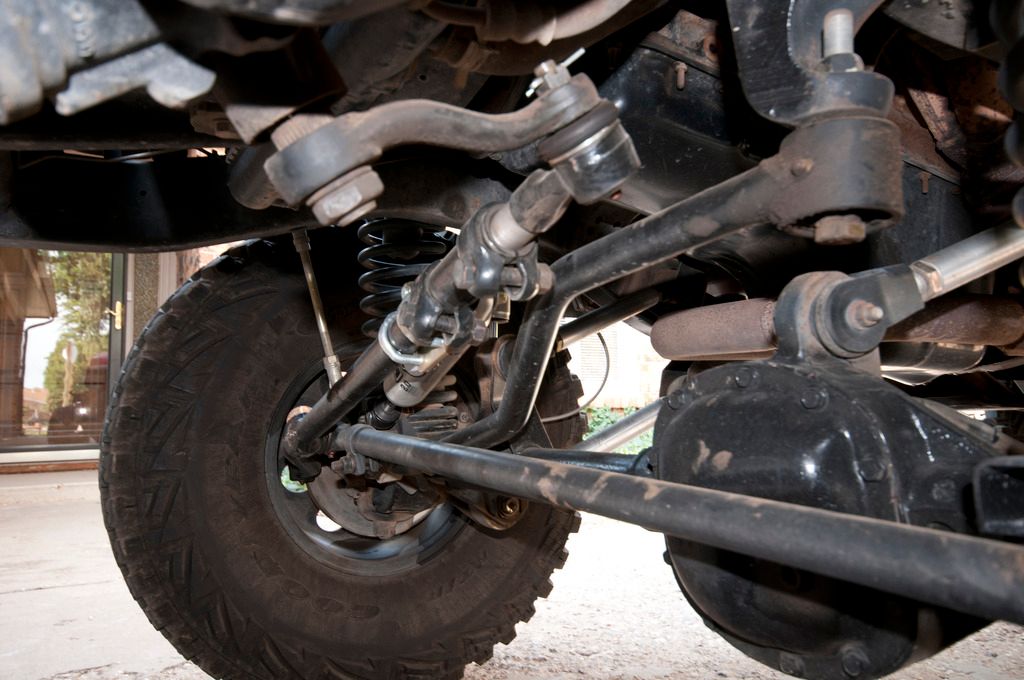

Hey guys.. I just installed savvy/currie ultimate steering on my jeep about 3 weeks ago.. and have been trying to fine tune the alignment etc. But I have a severe bumpsteer, Whenever I hit a low spot, pot hole, dip, uneven road, on one side or the other... I get a bad steering sway / bump steer. I'm not really sure what to adjust or do from here.
I have full savvy 4" lift 1.25" BL, with currie trac bars front and rear.. and front antirock.
I'll Note that before I installed the new steering.. the steering was fine.. no bump steer at all.
Below are pics I took today.

That's very mysterious issue you're describing. There's nothing wrong that I can see in your geometry and there's no dropped Pitman arm installed that would cause bump steer. Currie's steering kit itself certainly doesn't cause bump steer since it utilizes the same factory steering geometry that you removed.

What is your caster? From the picture it appears that the differential is tipped way too far up.
It's likely wrong... I haven't adjusted caster yet. Right now the return to center is non-existant.. you turn the wheel and let go... it's stays in that direction.
Edit: I just went out and checked with an angle finder... the ground the jeep is sitting on shows 0 Degrees... and the caster shows 5.5

Get your caster adjusted, that is your problem not the steering linkage.
