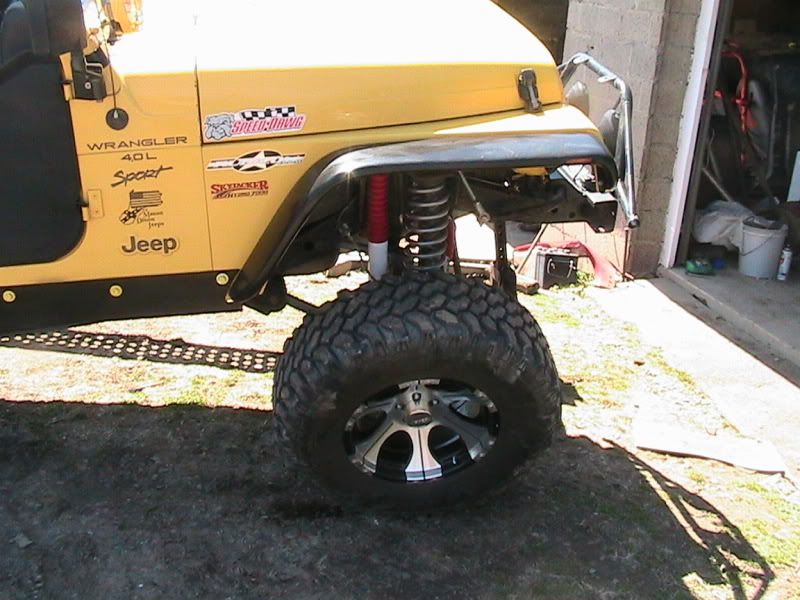

Go rubicon express not roughcountry . . . believe me i've had them both!!!
Here's mine on 35's with the rubicon 4.5" SF lift and a 1"BL

How did you like 4.5" on short arms? Im kinda worried the geometry is weird when flexing. As in the second picture, I can see the coil bent back slightly. Is this detrimental at all?

i would suggest the RE 4.5 superflex with 3.5 springs. later if you want you could go to the 4.5 springs too. keep in mind the 3.5 is actually about 4.25" so i would do that before anything else if i were you...just forget about the body lift. you wont even need a SYE with it but maybe get one in the future, just for the minor vibes

What are the advantages of using the 4.5" system with 3.5" springs? The reason for the body lift is to allow for the SYE and a TT. Im pretty sure Ill need an SYE too.

the 4.5 RE kit is more complete. using the 3.5 springs allows for all the clearance you should need while still keepin your center of gravity as low as possible. to be honest the short wheelbase jeep doesnt need any more lift then that to clear almost anything unless you want larger tires.
