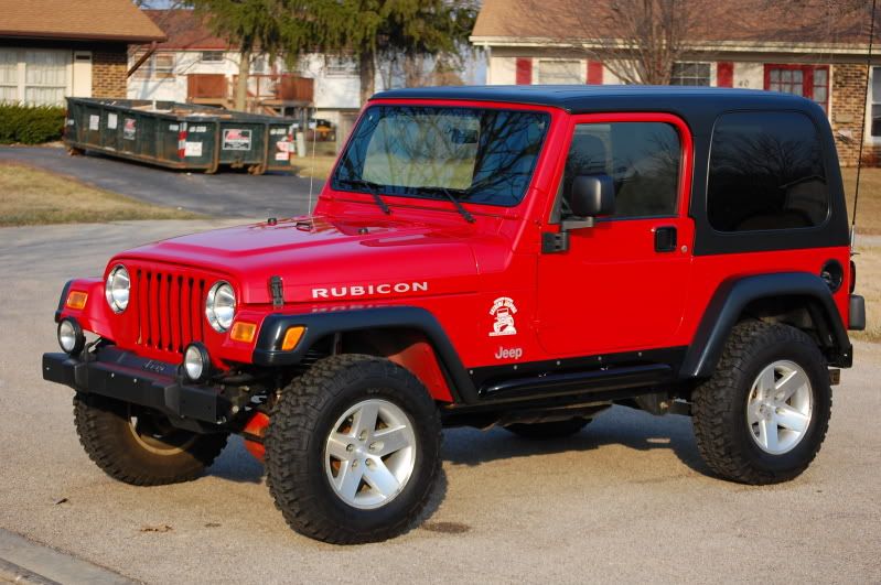

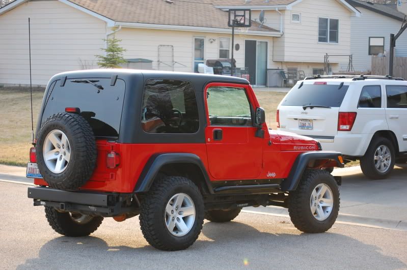

I was in the same boat a few weeks ago and I talked to some local members of my club and all of them said that a full suspension lift was superior to a BB. I've read many bad things about the RE twin tubes and was going to go with the RE BB with Monotubes ($410). Then RC has been getting a lot of great reviews with their spring lift. So I took the advice and went with the RC 2.5" lift for $310.
I really like the lift. I rides close to stock, but not as good. I had 50K on my jeep before I went with this lift. I did not have to use the TC drop (i used them as seat risers, lol). I figured if I wanted to get another lift, i'm only out $310. Not to mention I also saved $100 over the BB. IMO, the RC lift is well worth the money and time i spent on my Jeep.
I do have a small rake, but nothing to really complain about since I had a rake to begin with.
Here are some poser pics...don't have any wheeling yet...
