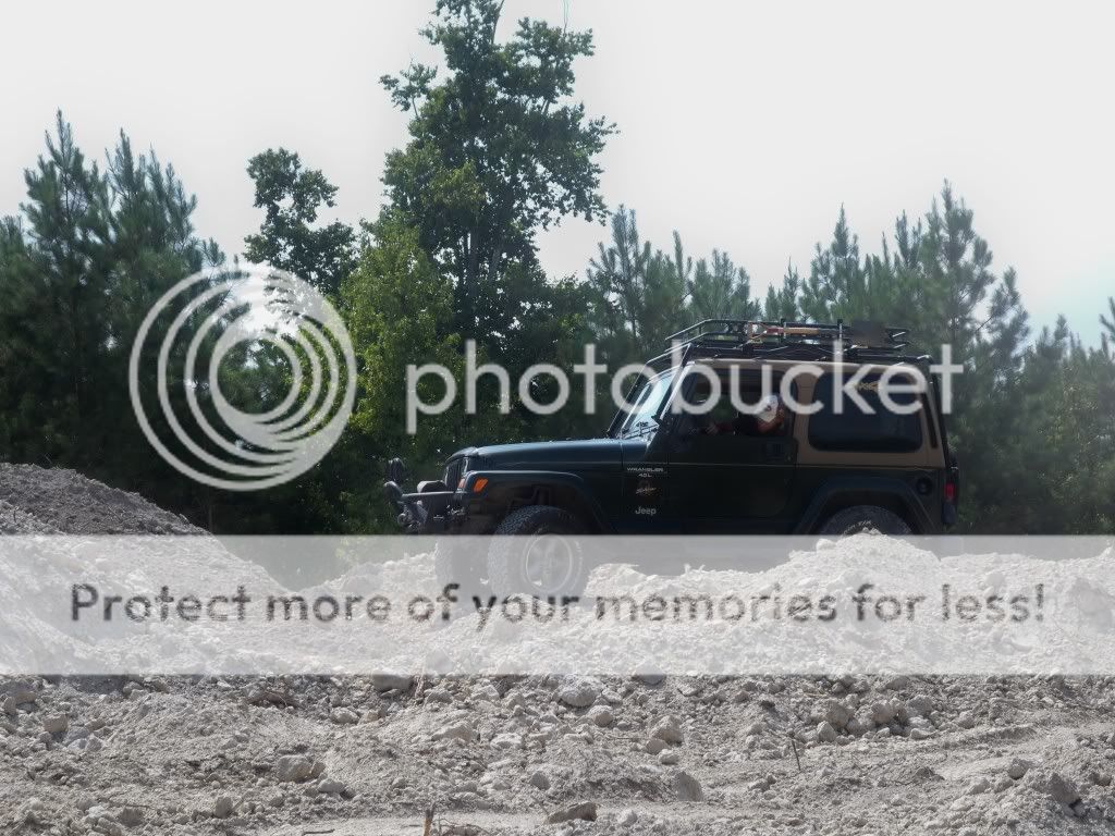

It just sounds so strange to me that I can run it through that much water and be fine, even do stuff like this: (2 days before I left)
and have no problems, but it takes a 7 hour ride for the water to do damage?
