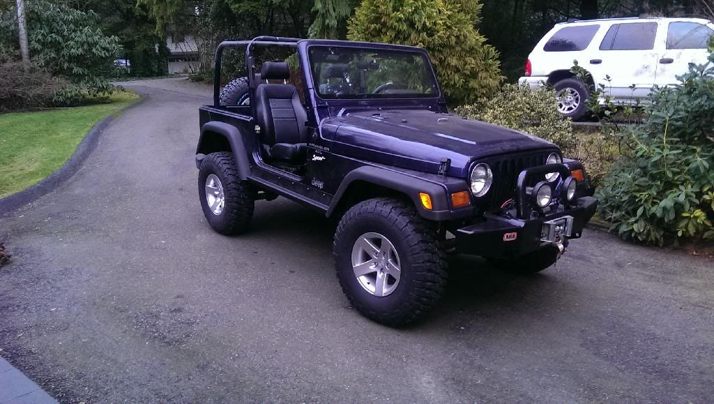

Here's a pic just because (it just underwent a significant refurb- my parents gifted this jeep to me after leaving it sitting for a few years with a water leak in the cabin- yuck).

PS- I know the jeep looks really raked in the picture- this is because it's parked on a hill, and I hadn't installed the hard top or doors yet. With everything on, it sits pretty level (with a slight factory-like rake).
