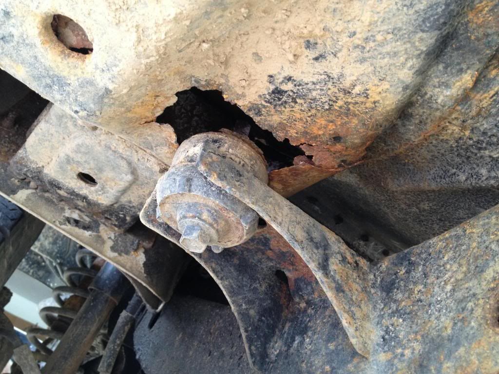

I know I'm beating a dead horse, but I want to confirm what I should do because there are a lot of people who have said to go about this certain ways.
I am having rust issues with the front two body mounts on either side of my '97 TJ. The middle two look like they're just collapsing while the front two where your feet go are completely rusted out. I have no experience welding nor do I have a welder, so I'm trying to find a solution to this that will involve as little welding as possible. Now I went to http://www.classicent.com/jeep.php and found the "Under Floor Torque Box Body Supports for all TJs", and while it looks like it's the piece I need, $625 for both sides is a little pricey for me at the moment. And also, if I do go ahead with the Classic Enterprise pieces for this, will I still have to weld them in? Or are those extra holes that aren't for the body mounts enough to secure them?
Pic order: Driver side front mount, driver side middle mount, driver side rear mount, passenger side middle mount, passenger side front mount.

Start looking for a tub, much cheaper than what you about to try. Plenty of them down here for less than 500. And get this no welding when you do it that way.

I second the new tub. Mine looked just like yours so I got a new tub for 300. If your tub is rotted that bad, there are most likely spots you can't see that are bad too

I did it in a one car garage. Pretty dang simple. Tip, pull jeep in front first so you can haul the body out without having to move jeep. Body is not that heavy but its a 4 man deal or a larger engine lift. I had the later. Got it on sale. Or if you got a large tree.
Electrical harnesses will need to be disconnected. And the steering(tie the wheel to the column so it dont turn and tear up the clock spring) trans fer every thing from yours if tub dont come with it. A weekend deal for most. Get CANS of BPblaster and soak away. Get cutting disk and cut all the bolts that just dont want to come out. Only like 12 or 9 bolts hold the body to frame and another 20 or so to the fenders. I would leave the fenders attached to the frame. They have a lot of crap their holding and just more work to remove them.
Be prepared to go to hardware store and get new bolts. Yours are more than likely fired. Buy some Por15 so when you do get the body off you can clean and paint the frame to keep rust away. Can even Rino line the bottom of your New tube to stop some of those issues.

Upon further reflection, and after seeing the condition of all of the mounts, I agree replacing the tub might be the best idea. Plus, assuming we get a no-rust tub, we can apply rustproofing to it, and do whatever we need to do to the frame and anything else underneath. (such as the fuel pump)

I went the classic enterprise route on my old tj. Driver side mounts were rotted out pretty bad.
Since I didn't have access to a spot welder, I used heavy duty rivets( required the use of an air riveter) and heavy duty 3m epoxy.
Took an afternoon of my time. Easier than swapping out the tub in my book.
