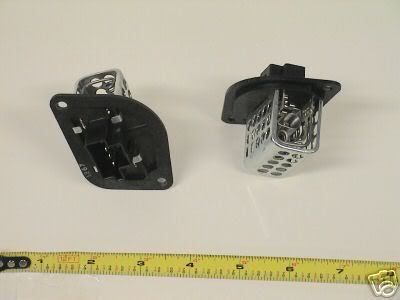

Is this blower the resistor?

yep, looks exactly like the one on my 97....

Where is this on the 97? Is it behind on the glove box also? I'm having the same problems, blower works on high and that's it. Had the smell of something burning before it went.

My 3rd fan speed went out..only works on the first 2 and high...had the same burning smell a few times, thought it was the vaccum hose that craped out and had it replaced....
You don't have to take the glovebox out, I just replaced mine. Under the glovebox where the passengers feet go is a black in color "kick plate", remove this and you will see 4 colored wires which plug into the resistor. Unplug and remove the two screws holding the resistor inplace and exchange. I also had one of the 4 wires melt (also had the burn smell) and picked the kit from DC to replace the wires.

Thanks for the reply, foreverjeepin, I'm going to get on that.
