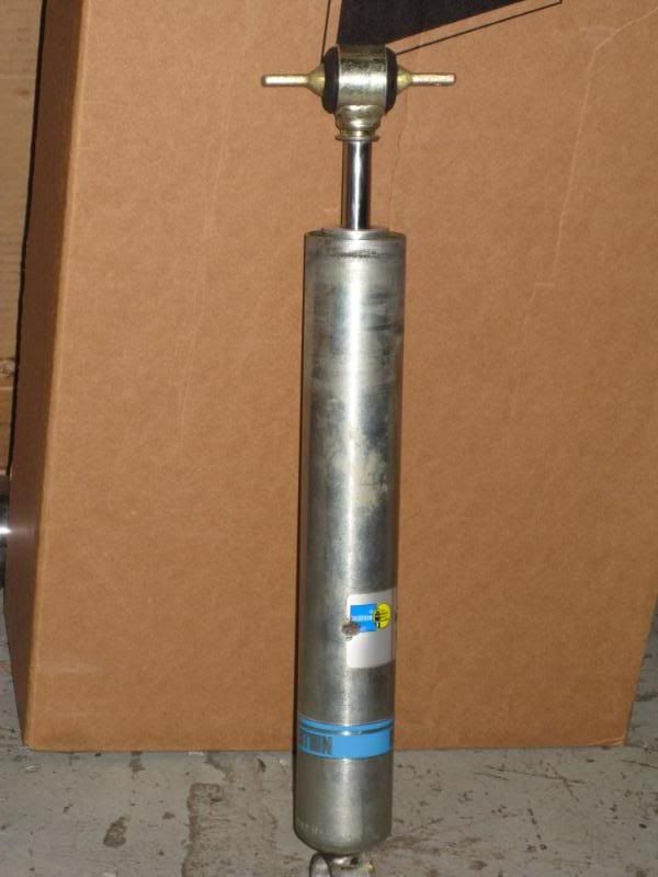

I rarely use bilsteins however I do like the ride and quality they offer, the reason is how easy they are to damage. All it takes is the slightest ding from a rock flung out of a tire, tire chains/cable/ a run over winch cable, obstacles, most comonly on tj/lj's.... unrelocated rear lower mounts so the shock can clear the spring/spring buckets/exhaust and the piston/valve hangs up on the ding.... most other brand shocks can take a beating to the outer shell and keep on working, bilstein will not.

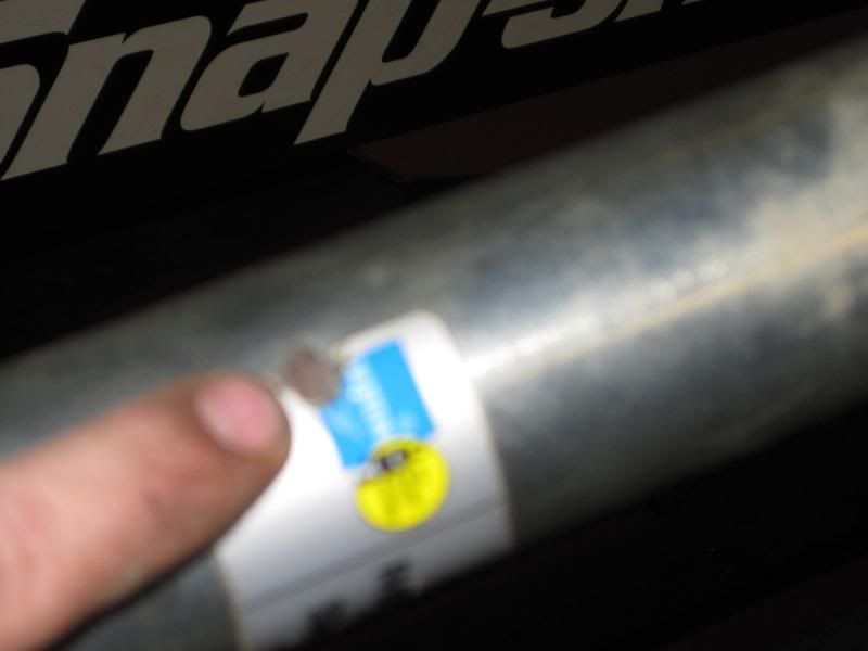

Now this is a perfectly good but junked shock, my finger is pointing at the ding that has the shock litterally stuck...
