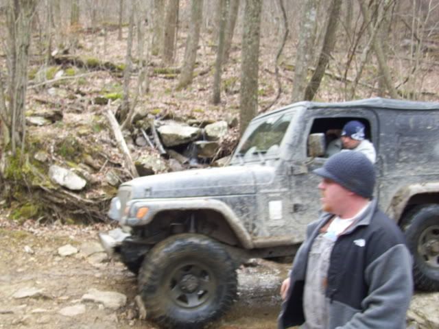

33's on a 4 banger with 4.88 gears and i can keep up with everyone else in traffic and beat most 4.0 on the trail but it takes alot of time and money to be able to drive it comfortably as a daily driver with bigger tires. it can do it no problem you just have to re-gear the heck out of the it also adding the 4.0 throttle body made a huge difference
http://img15.imageshack.us/img15/207...9616316792.jpg
http://img29.imageshack.us/img29/507...1616116792.jpg
