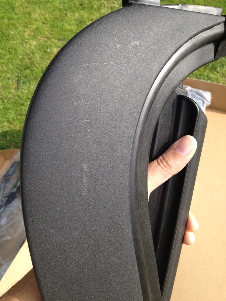

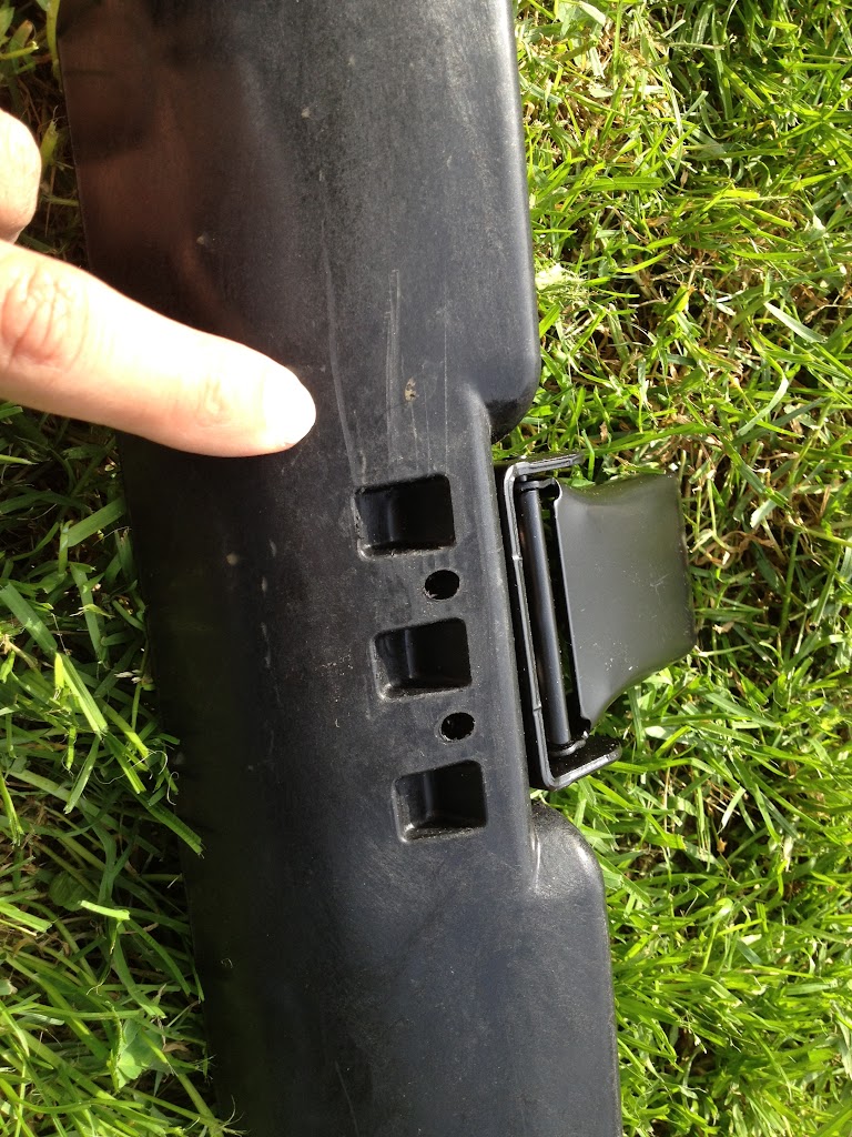

I got my NX frame/hardware set and 2pc soft doors a couple weeks ago and I have to admit, I'm less than thrilled with the quality. I live in Asian and had to ship it to a friend state side and then carry the entire thing all the way back home to Taiwan on my flight. I can't imagine how pissed off I'd be if I actually payed to have it imported. The header bar showed minor signs of rust and had scuff marks on it.
The window surrounds were scuffed as well.
The packaging was ok so I imagine it left the assembly line like this. Also, the two piece soft door instructions show special anti-theft screws for fastening the door handrails. However all I got were standard Philips head screws.
These issues wouldn't have been that big a deal had I not spent 800 bucks for the stuff. Thank god I was able to find a decent fairly priced OEM canvas.
