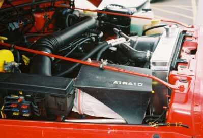

Not a good picture, but if any of you can see anything else aftermarket besides the cold air intake feel free to respond.
Too small for my old eye's to see...
if you click it, it opens in imageshack and if you click it again it should blow up to full screen.

Don't oil the air filter, get a wet/dry shop vac paper filter bag from Home Depot (5 for $4). Nice clean engine bay by the way...IMO
Is that an exposed fuse holder on the side of the PDC?
